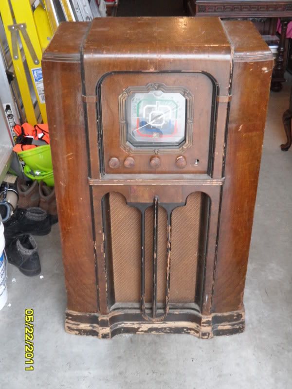

What has a chrome chassis, colorful mirrored dial, 12" Jensen speaker, and 13 tubes? I paid $100 for this Western Air Patrol W492 (chassis model 2136, the Gilfillan 1331C has the same schematic and a different dial) on May 21, 2011.

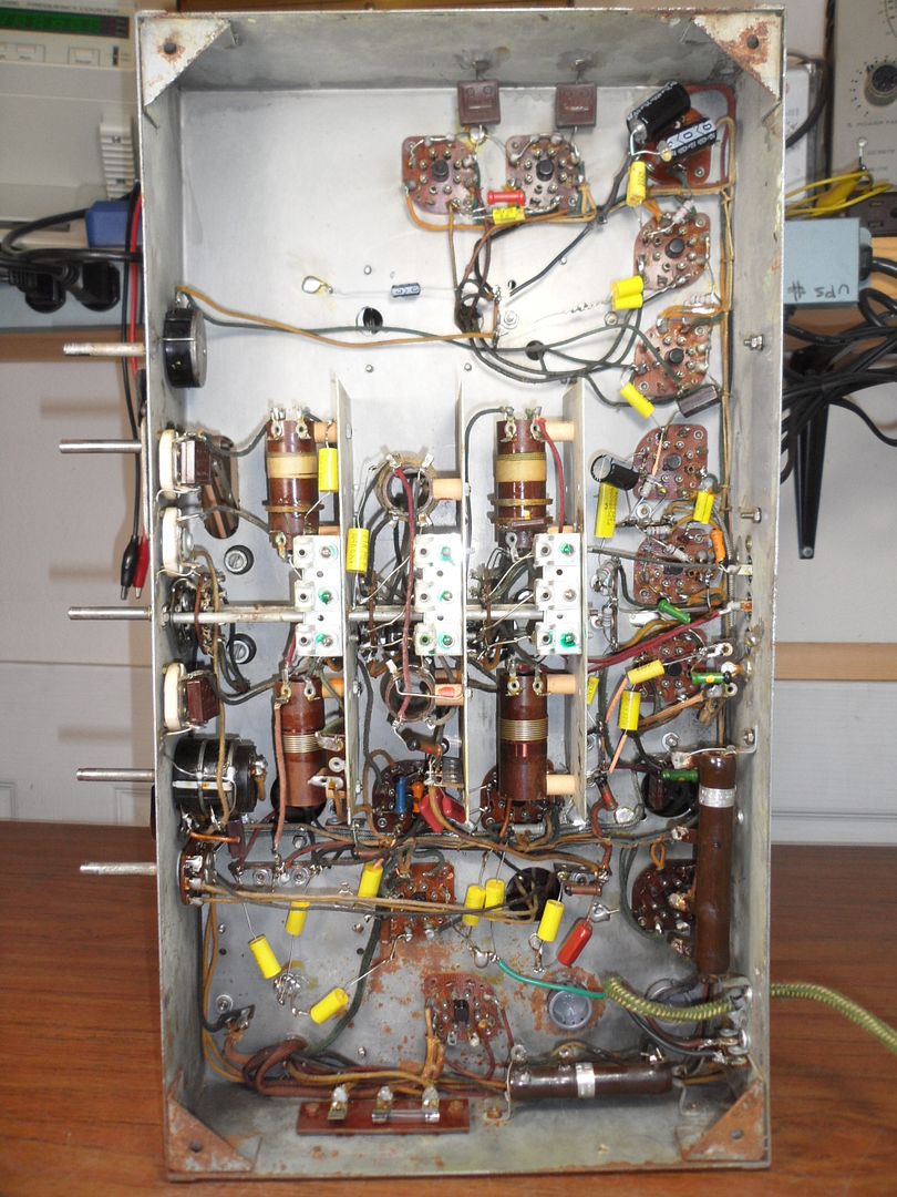

I was eager to hear this one, so I've already replaced the capacitors and bad resistors just five days after getting it. I've not yet aligned it, but it sounds excellent, and is receiving stations well.

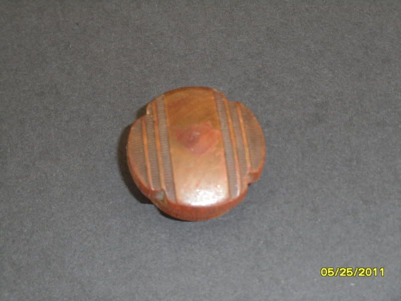

I needed one knob for it, and it is on the way thanks to Kelton (radioaddict):

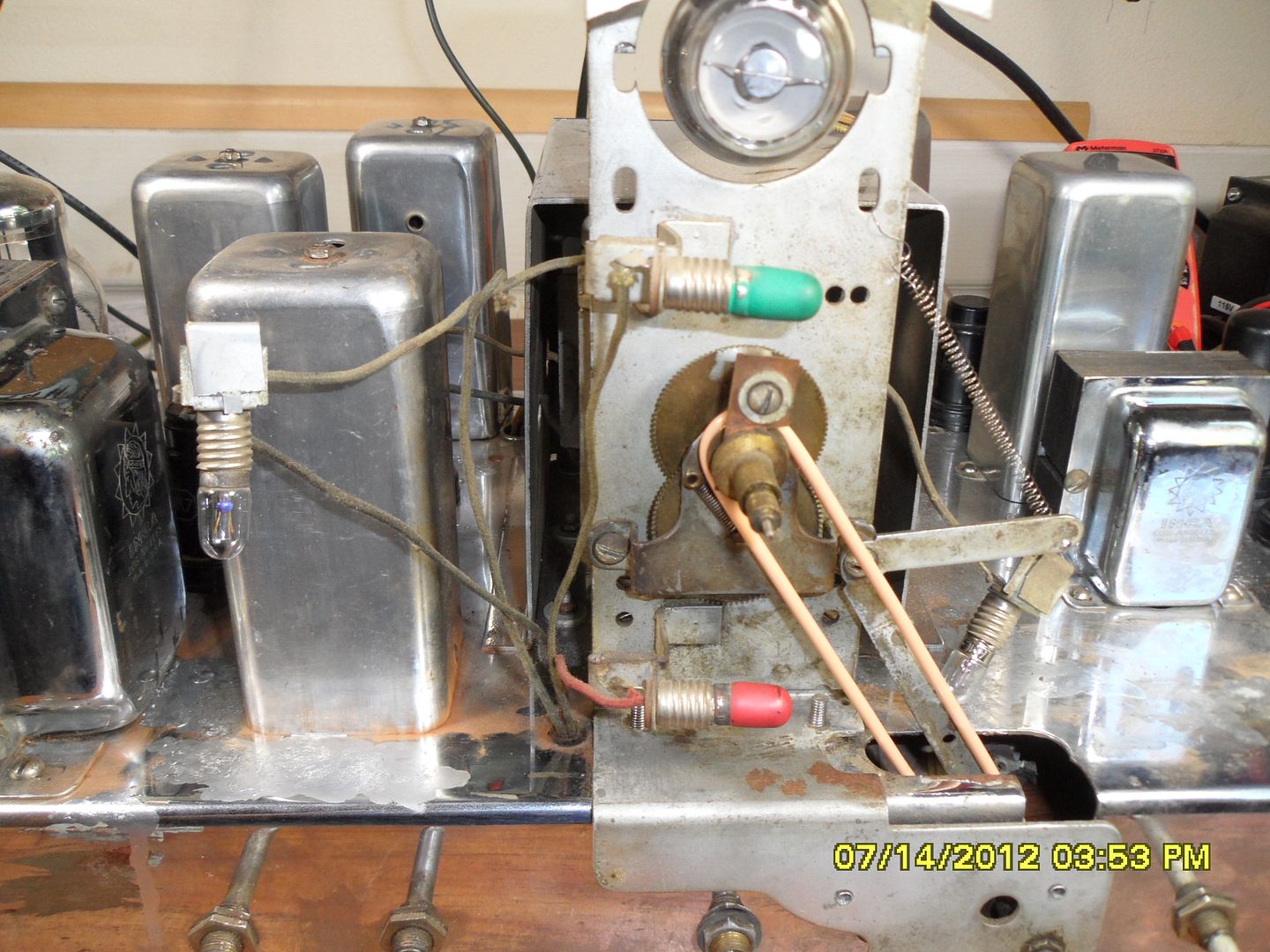

One anomoly - there are three bands, two colored lights (green for AM, red for SW), and a third wire from the dial band light portion of the ganged band switch assembly. I haven't yet found any place for a blue light for the middle band (these are the colors on the front of the dial).

The knob from Kelton (radioaddict) arrived yesterday, and is a match. Thanks again!

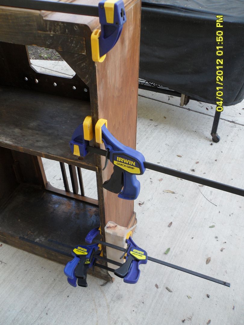

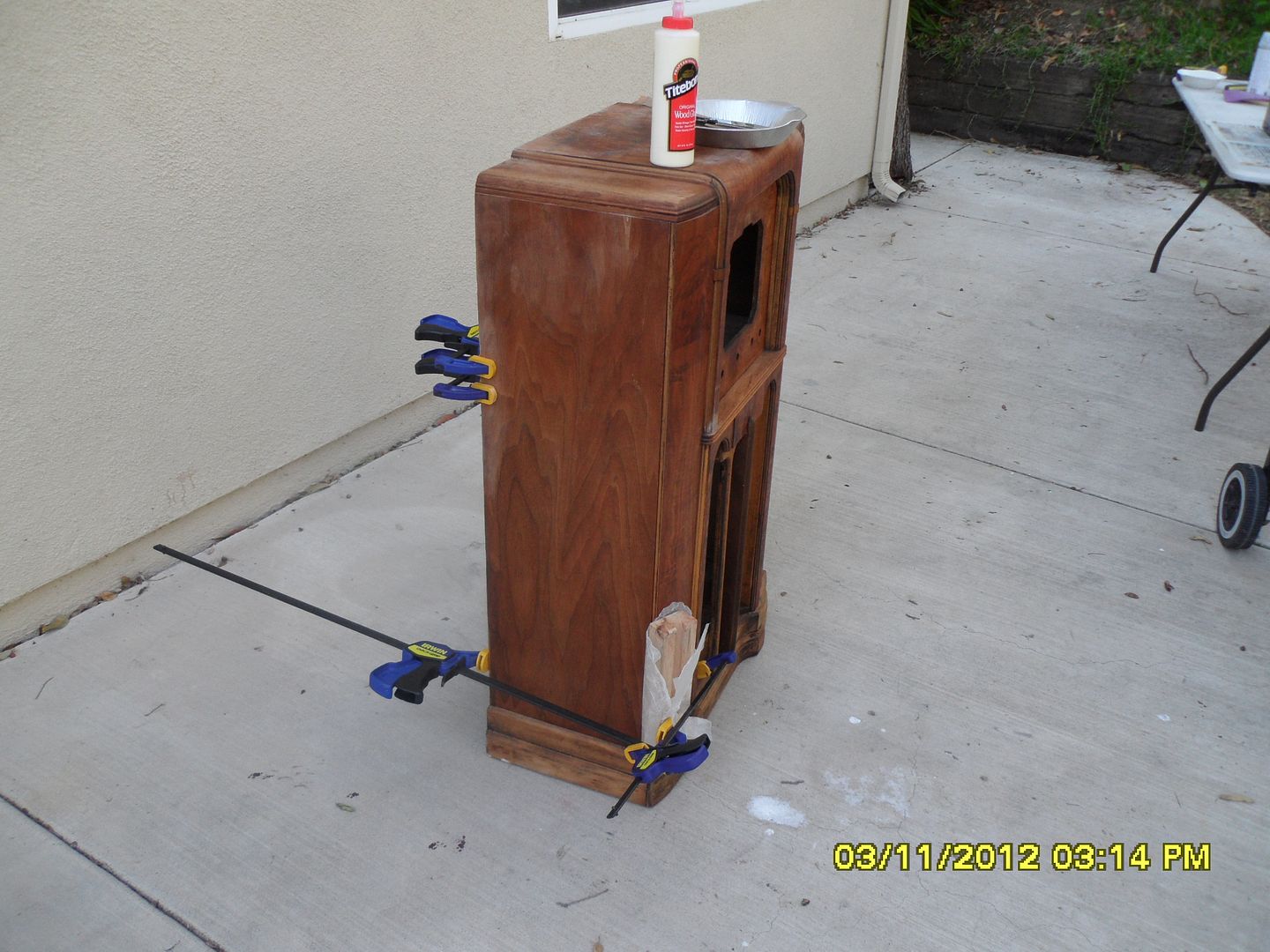

I hope to finish the veneer repairs this weekend (back edge damage on the top and both sides, a few other spots).

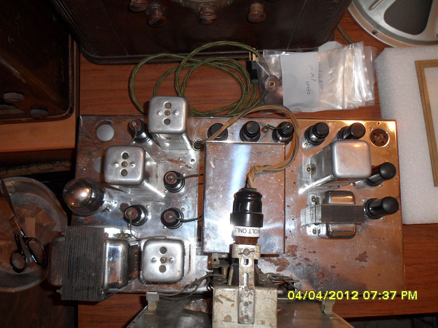

The radios sounds and receives well, even thought I've not yet aligned it. I expect it will be quite good once I align it. I was waiting until I had a good frequency counter to see my signal generator accurately. I have that now, so can finish the chassis.
One odd thing on the chassis. There is a wire for blue light when the "ploice" band is selected, but no light. Apparently, they made the mirrored dial face with no opening for a blue light! I think I'll put one beside the red light for the shortwave band.

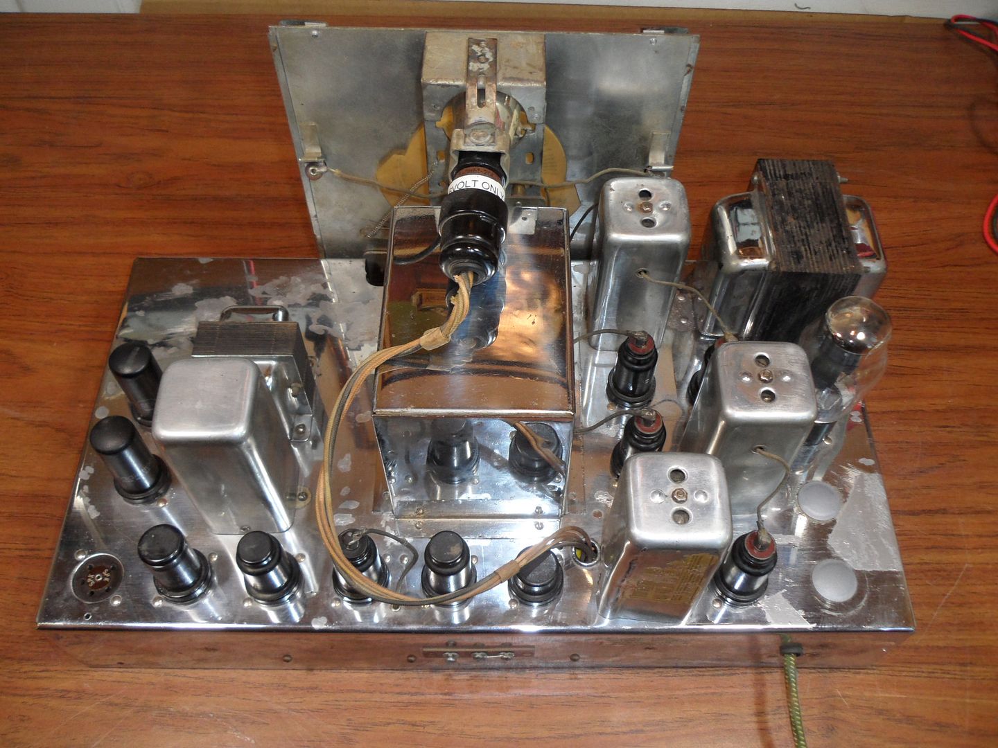

Here are some photos of the current chassis and veneer repairs underway

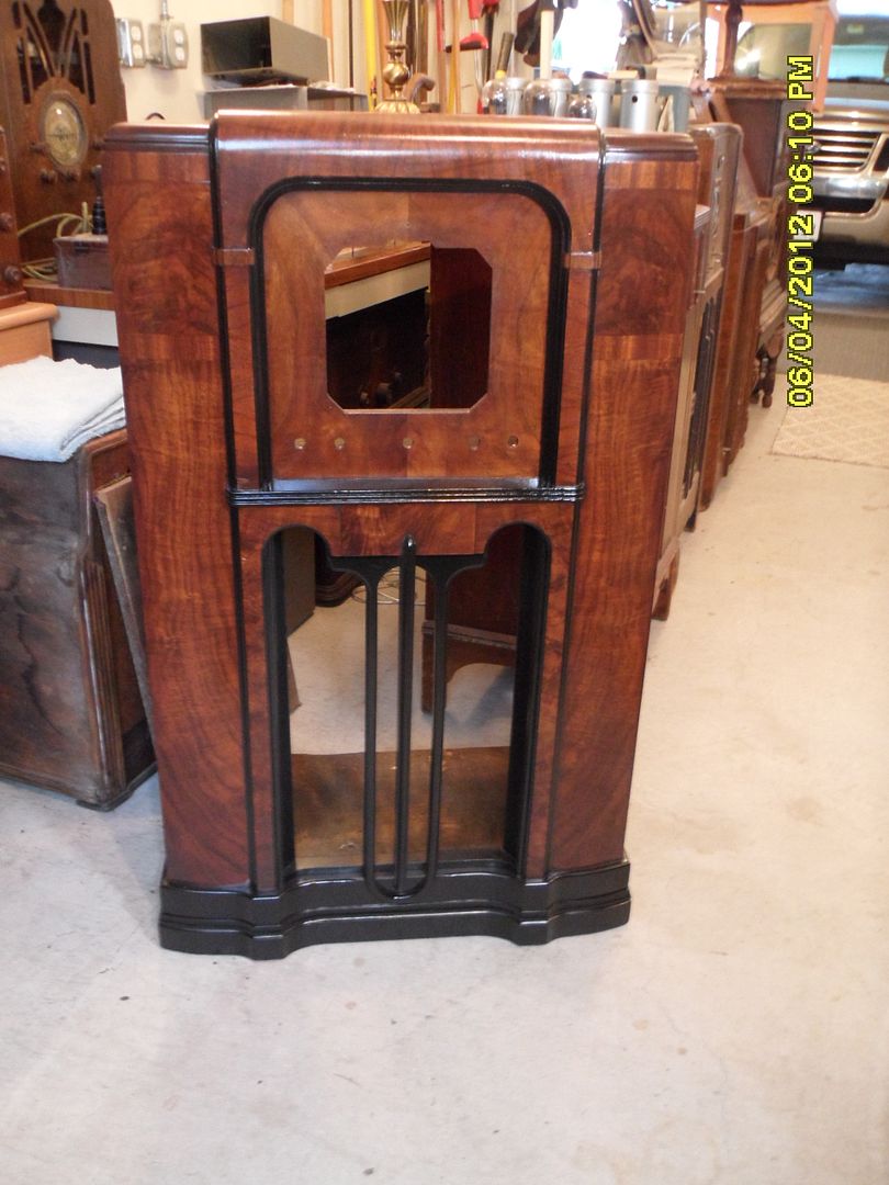

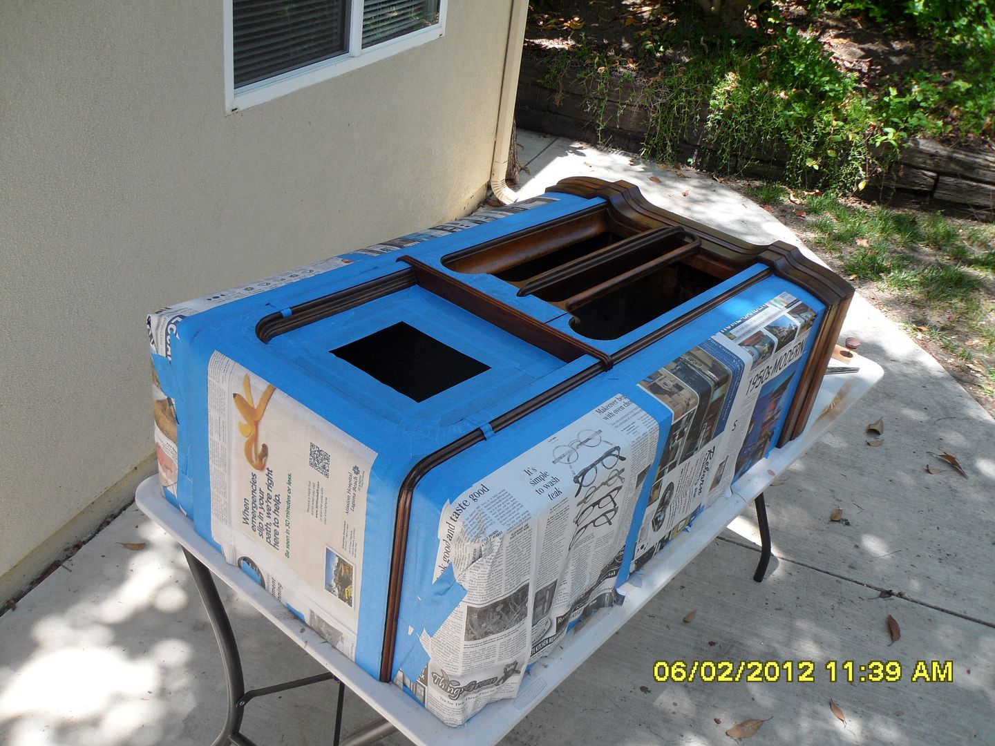

Spraying the trim which is supposed to be dark brown required quite a bit of masking work
However, the radio looks far better now. From here on out, I just need to wet sand, spray more gloss clear, more wet sanding, and final polishing before assembly.

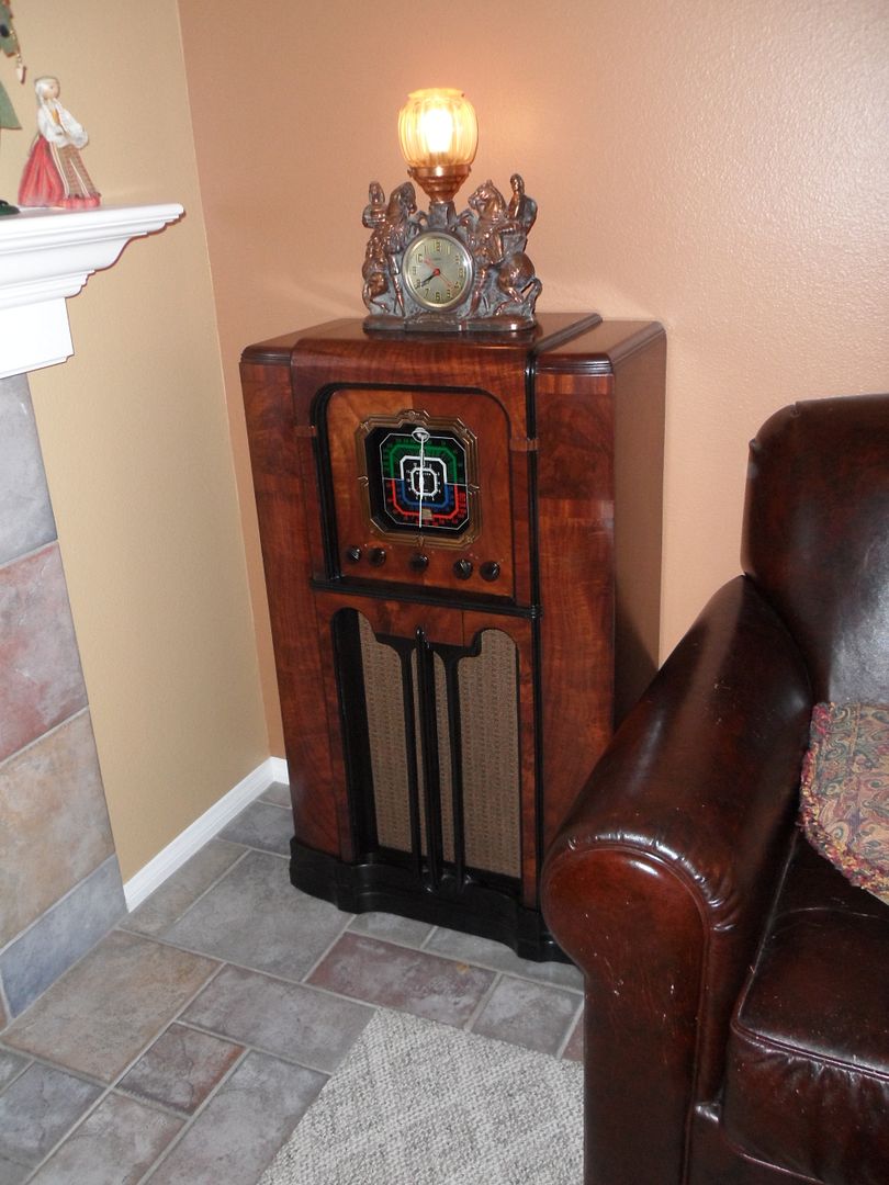

It is finished. I'll post a few photos today, then more tomorrow or the next day when I have better light.
Here it is this evening with a clock lamp which seems to go well with it:
The radio was apparently made with no light for the blue shortwave band, but it did come with a wire for that light. I could find no evidence of a place to mount a blue bulb, so I used JB weld to attach a socket. I put the red light at the bottom and blue above, as that is how the bands are located on the dial:

The bottom of the chassis
