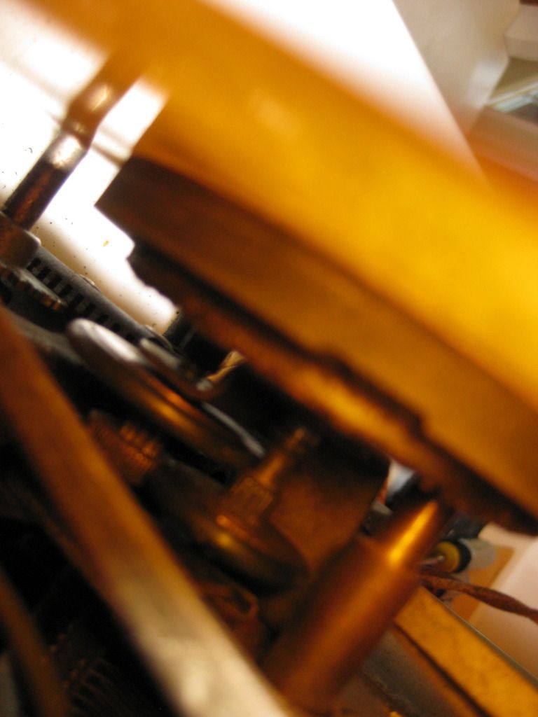

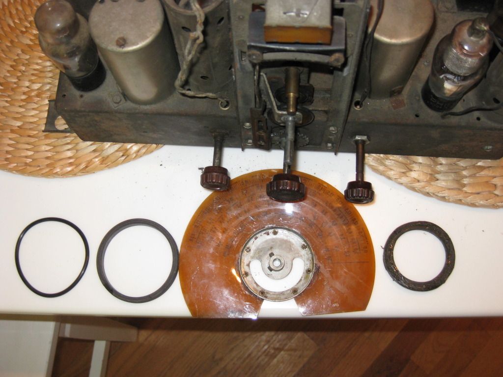

Okay, here are some pics:
Tuning mechanism with nice fresh o-rings:
same pic, other side:
inside the back of the big dial, are there supposed to be belts or rings inside and outside this thing?
a different view, same subject:

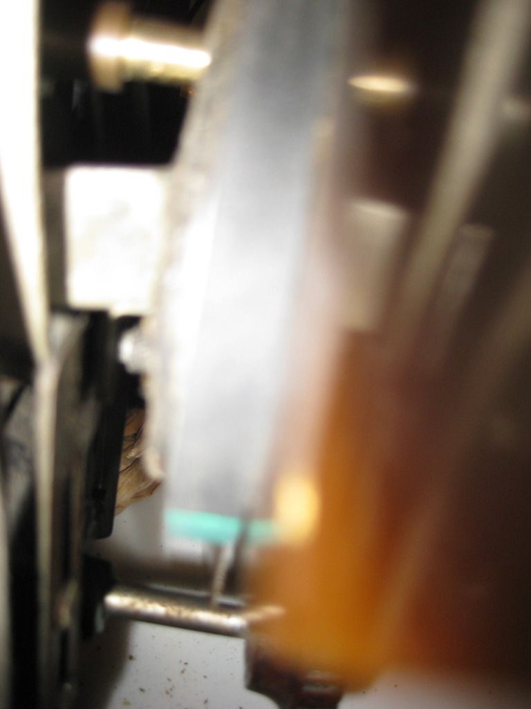

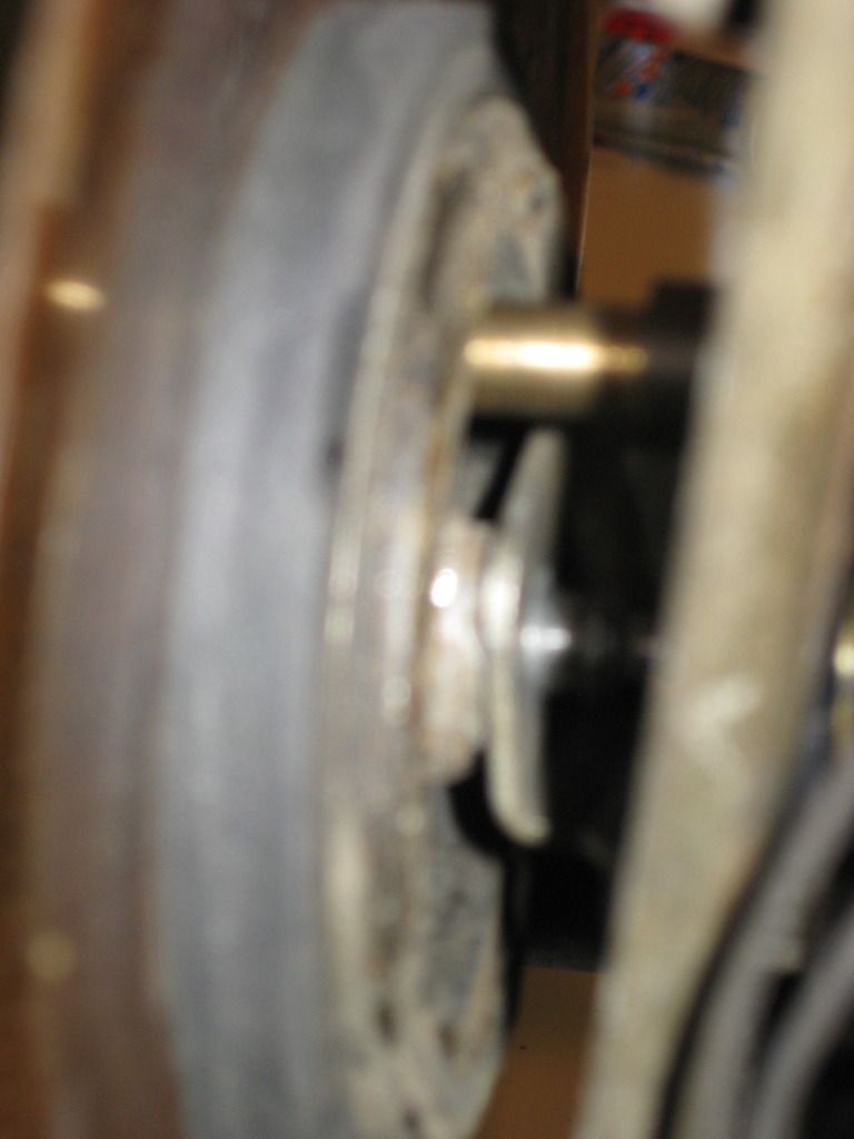

so when i put the big dial on the shaft, nothing touches the two gear things that would turn the tuning capacititor.
here are a bunch of pics trying to illustrate that:
in my opinion, the only way this would work is if that inside gasket on the big dial was like a half inch or more wider and would stick out and catch that lower and up drive shaft..
maybe mine is missing a part?
any comments are appreciated, thanks

man, those clearance pictures are crappy.... if you go to the first pic and see the fresh o-rings, you see kind of 3 shafts sticking out there... the top shaft and the little nub of a shaft at the bottom have to be connected with a belt in order to turn the tuning capacitor. the little nub and the top shaft really aren't anywhere close to those o-rings behind the big dial...

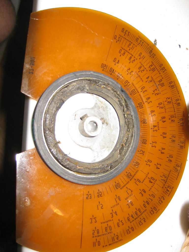

Steve, yes, if you look at this back of the big dial pick, u can see the back of the dial seems like it has an o-ring on the inside and outside:
The inside o-ring would have to fit over that shaft and the one on top of the 3 shafts to tune it. And that o-ring doesn't project out far enough to hit it, no matter if i move it on fine tuning or large tuning...

EUREKA!
Here's what i have been doing that is so dumb, I have been putting the big dial on the long shaft in the middle instead of the top shaft... Man I am a big dummy! Anyhow, looks like it will work now. So FYI for posterity, thanks
The 11th viewing of the video did it for me :-)

okay, guys, here's the deal on this, just recording it for posterity really. in that video, the gentleman pulls that o-ring down and wraps it over that drive wheel, that did not work on mine, no matter how many times i tried it, with o-rings and oil-filter gaskets. how i think that is reall designed is that the o-ring is a thick one and it sits completely around that ring and turns the drive shaft from contact above it, not wrapped around it.
thats what i have going right now and it is the only thing that worked.
anyhow, 80 year old radio information, for those who need it :-)
