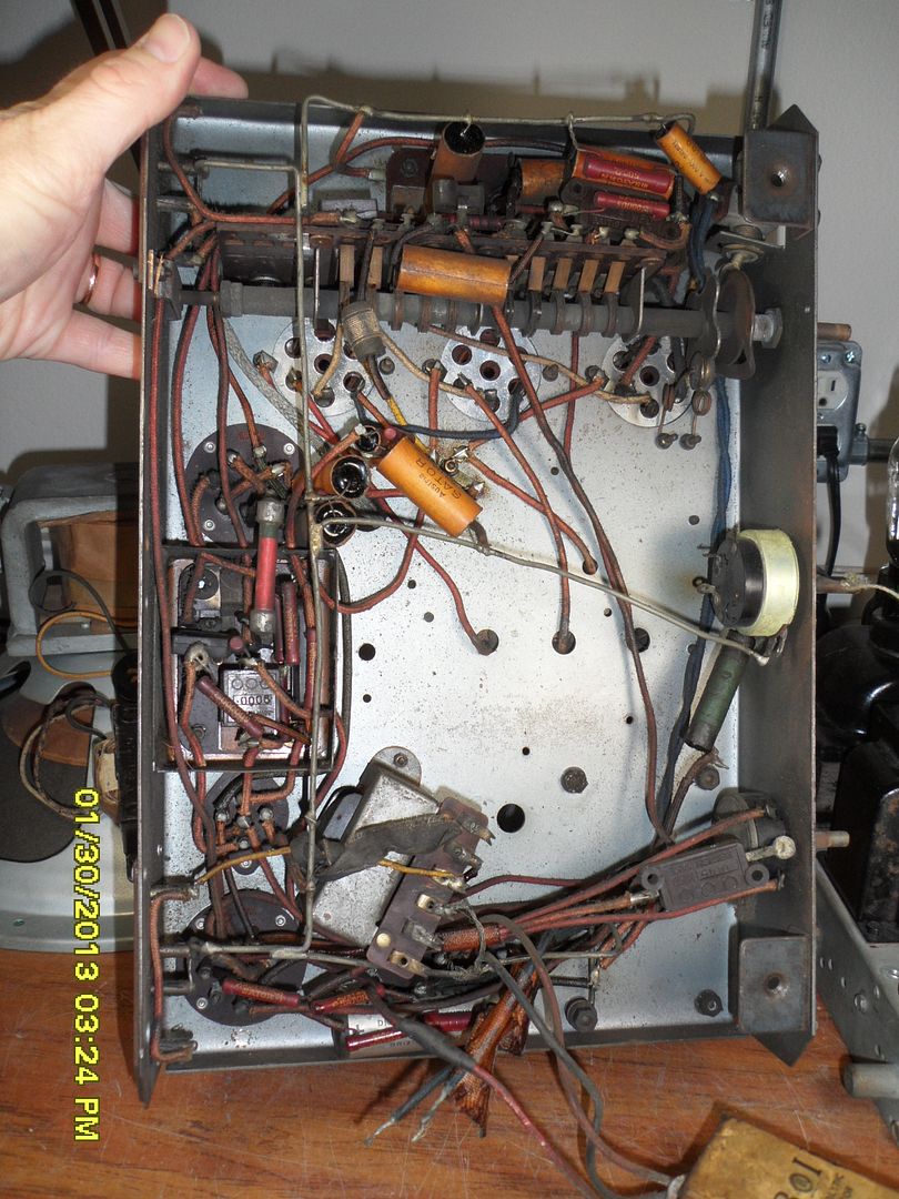

I bought this yesterday for $75.12 and would appreciate any help determining the model and other information. It has five tubes: R2 - rectifier; PENA4 - power; 2D4A; VP4B; unknown with 9-pin base and top cap.

Being curious, I removed the chassis. I see one small dangling coil, perhaps an RF choke (upper left, between the band switch rod and the ground buss), but it appears to be otherwise routine. I'll either need to search with a magnifying glass to find where it was connected, or obtain a schematic.

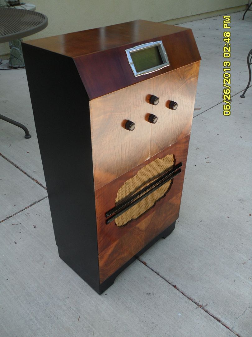

The cabinet came out nice. I have not yet decided if I will change the grille cloth. Finishing the chassis will have to wait for a while, as there are 6 or seven projects to do before I resume working on it. I found an intermittent connection under some old insulation tubing in one of the field coil leads, so it will interesting to see if soldering that makes a difference. It should. Since I started work on the chassis, I've also bought some controls with switches, so will be able to install a proper on-off / volume control to replace the bad on-off switch on the band switch.

looks home made by someone who had some nice wood
