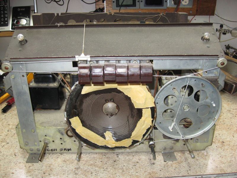

Great timing on the reopening of this thread . I just pulled the chassis on a customers RCA 18 T and the speaker is really trashed . Lots of masking tape and glue all over it. Good thing is that the radio does operate but of course you can,t turn up the volume much before the speaker starts to rattle. I ordered the speaker cones ( Only $13.00 for two ) from the site i mentioned plus i have a few 6 inch PM speakers around here. So we shall see what happens

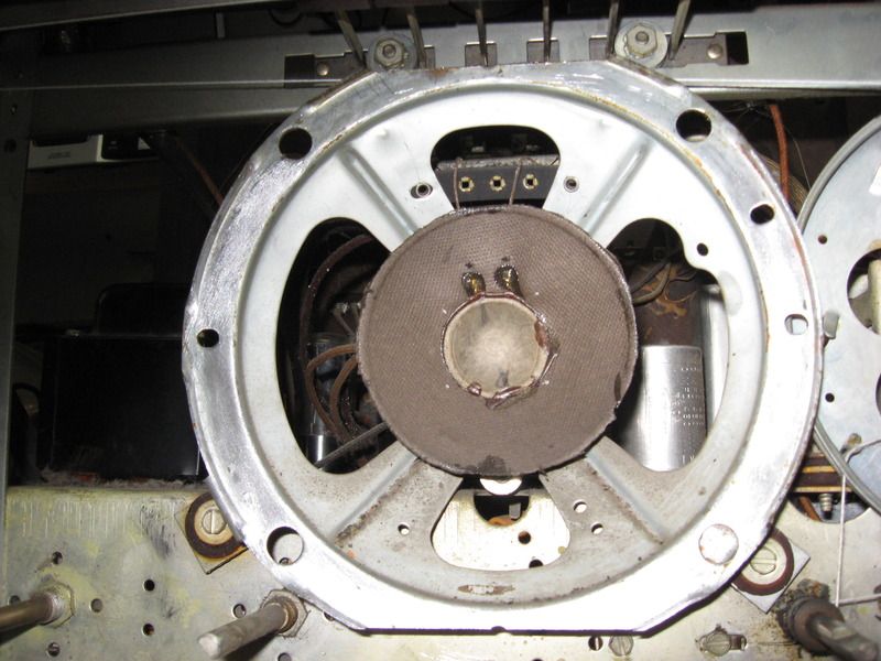

Here are 3 pictures of my reconing job. First is what the speaker looked like originally. Second is all the bad parts cut out and third is the new cone installed. On the third picture it was not glued in yet. I used Weldwood contact cement. After gluing it in and letting it set for a few day i tried it. Sounds great and it is a foam edge type speaker.

Will that bulgy foam surround hit the inside of the cabinet? If it does, the tone will be "mushy".
