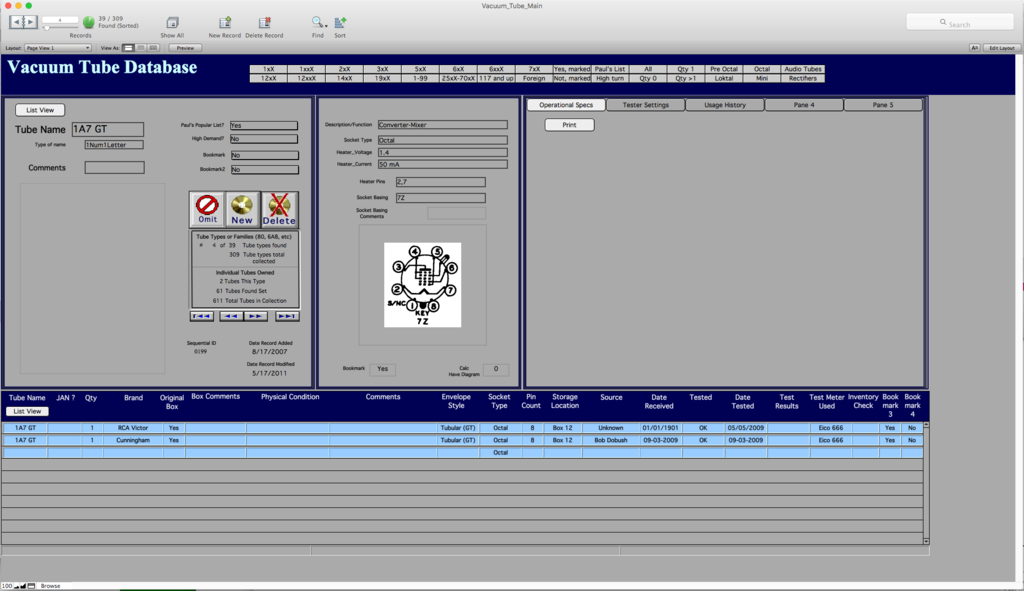

Here is a screen shot of my Filemaker based tube database. It tracks what I own, what I have used, it has basing info and general electrical parameters for quick glance. My collection is tucked away under the work benches which makes it hard to rummage thru to know what I own. Thus the existance of the database.

That looks nice Dale!
What version of Filemaker is it?
Did you make it from scratch or use an existing database as a template?
Aloha, Ken
No Console Left Behind!
 Post subject: Re: Excel file for managing tubes
PostPosted: Dec Tue 20, 2016 4:55 am
Posts: 7358
Location: Minneapolis, MN USA
Filemaker v11 from scratch. Lots of determination and time.

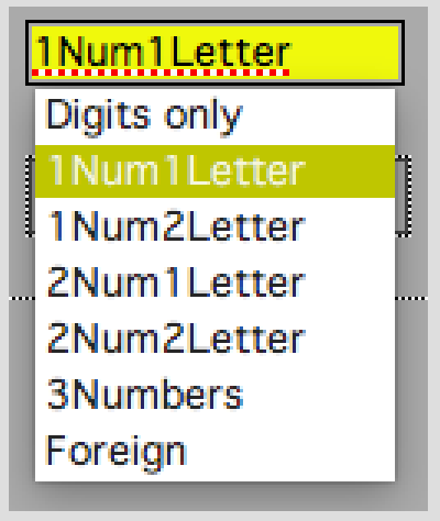

Displaying tube names in a sensible manner does take effort. But it is doable.
I like my sort results to show tube names by count of characters not including the envelope style.
So 80 comes before 6a8 which comes before 12SK7, etc.
I solved it by using one field for tube name and another field for name type.
Sort by name type not by tube name.
Digits only would be tubes 45, 80 etc
1Num1Letter would be 6a8, 6L6, etc
2Num2Letter would be 6SA7, 1LC6 etc
