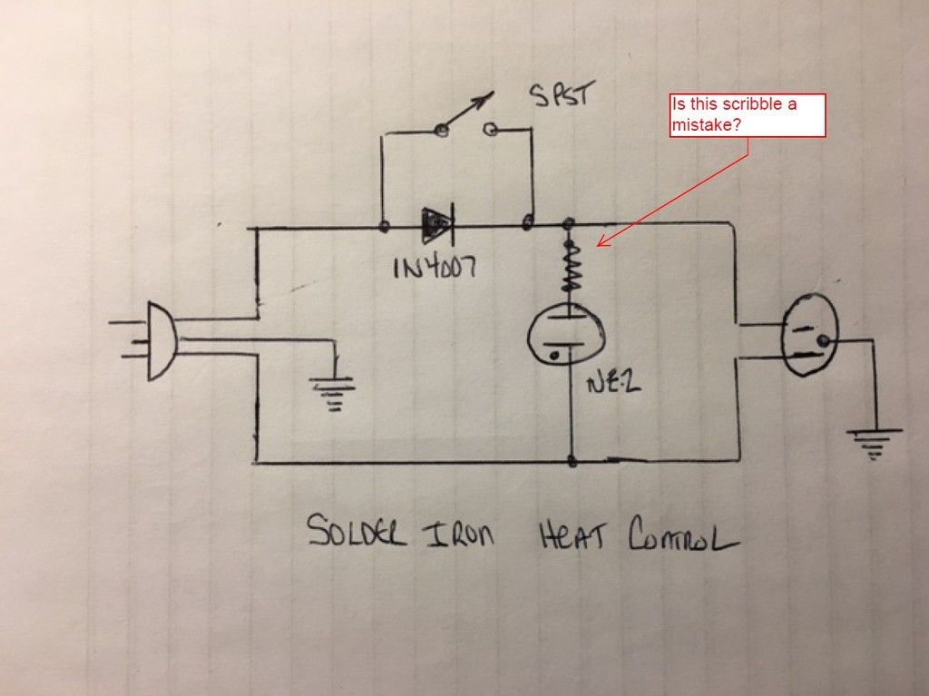

Although many of us now use a nice temperature controlled soldering station here is a simple circuit that
I have used for over 30 years. It is very handy when using a simple soldering iron.
I built this into a small metal enclosure around 1980. When the switch is closed the iron sees the full line voltage
and operates as normal. By opening the switch the iron gets voltage only during one half of the ac cycle so
cools down from normal operating temperature to save the tip. Closing the switch will bring the iron right back to
the working temperature in under a minute. The neon bulb glows at normal brilliance when the switch is closed
and about half when the switch is open and the iron is idling for a simple indicator.

The diode/switch arrangement is a good idea, but you may have to wait for the tip to come back up to melt temperature. I saw a holder built for this circuit that used a microswitch. When the soldering iron is inserted in the holder, it clicks the switch "OPEN." When you pull out the iron, the switch closes, automatically restoring full power.

I don't have a temperature controlled soldering iron and for the amount of time I use my iron I can't justify buying one. I'm going to build this but have one question:

That should be a series resistor, to set the NE-2 at its correct operating voltage and current. IIRC it's around 100k to 150k ohms for 120V operation, depending on desired brightness.
Thanks!

Don't try this with soldering irons that have a base with a step down transformer. The rectified DC will saturate the transformer and blow the diode.
