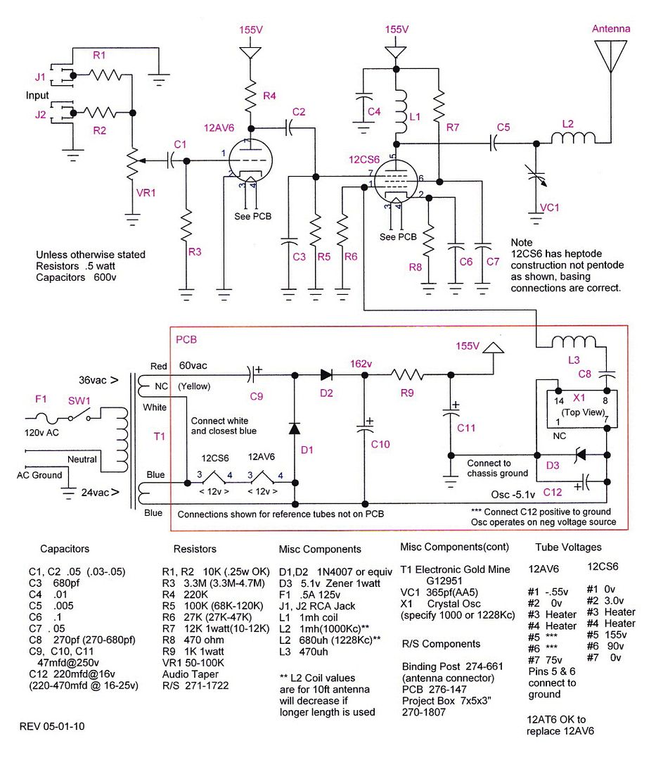

Finally a transmitter utilizing a single, cheap surplus transformer... Norm found xfomers at EGM with 24V & 36v windings that work great and I've been designing around it and the cheap(did I mention cheap?) 12CS6, many vendors have these for a $1 each... Also uses the common 12AV6 or 12AT6 almost everyone should have one of these laying around...
Broken links have been repaired 7/24/15
R/S PCB is cut in half and holes drilled to route wires from underside to one side, where the bundle(five wires) is tied together... This allows top cover to be raised at 90* angle without stressing wiring... Chassis wiring, utilizes one of Bob Weaver's Earth Potential Facilitators, for grounding...

Looks great, noticed that release date 4-01-10.
Bill - I have plenty of these transformers and EGM has thousands. Shouldn't have a problem with running out. I can send you groups of 12, Priority Mail, when needed. They can also be bought direct from EGM.

What's the difference between the 12CS6 and 12BE6? I see them listed as one being a sub for the other.
PostPosted: Mar Tue 30, 2010 2:23 am
Posts: 37126
Location: Livermore, CA
Hi
Transconductance from grid #3 is specified on a 12CS6. A 12BE6 is an older tube which doesn't have transconductance from grid #3 controlled as well.
We use grid #3 as audio input so nice to know what to expect. Tom has done experimenting with different tubes. 12BE6 works but doesn't modulate as well. He will probably give details.
Norm
PostPosted: Mar Tue 30, 2010 3:25 am
Posts: 13393
The 12BE6 has a remote cutoff G3 and will distort with higher levels of audio input, same is basically true of virtually all pentagrid tubes used as mixer-osc in BCB radios... Most charts list 12BE6 & 12CS6 as subs, in reality neither likely perform for the other as intended...

Tom, How does this transmitter compare to the 6LE8 & 6GY6 transmitters for output power, sound quality etc.?
Sound quality is fine, only issue is it's easy to over-modulate with the 12AV6, a audio taper gain control is defiantly recommended... The RF output is approx 65% of the 6GY6, which has the advantage of not over loading the front end of a nearby radio... A 6GY6 version could be built using the CT of the 36v winding to buck the 24v winding, that would require use of a tripler P/S to get the B+ back up to near 150v...
Burnt Fingers wrote:
Sounds like a 3BY6/6BY6 would work also then if using a different filament arrangement.
Yes the *BY6 works(as does the 5915) but has considerably less Gm on G3, thus requires a higher level of audio input(not necessarily a bad point)...
I'm surprised no ones has commented on the power supply, specifically to the xtal osc...
Hmm, hadn't noticed that. Very clever.

Posted updated schematic dated 04-10-10, if you D/L the earlier version(04-01-10), please destroy it...
R7 & R8 have changed value and L3 was added to convert sq wave to a sign, gives improved modulation and a bit more RF output...
Likely this will be the only change ever made to this Tx, I've ran the prototype several hours and am very satisfied with it's performance...
