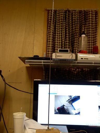

When I built the 6GY6 two tube transmitter I made this antenna for opeeration at 1000 KHz.
The telescoping antenna measured from ther base to the top is 39"
The coil came from a beyond repair antique radio and the big variable capacitor came from a vacuum tube operated FM tuner. I found a small ferrite rod inserted inside ths coil improved the output signal. Also that coil of wire was needed to permit proper operation of the antenna as it would not work right with the cap connected via short wire to the coil.

So, is that coil and cap taking the place of L2 and VC1 in the schematic on page 1 of this thread? I cant tell, is the roll of wire before the coil or after? The sum of your coil with a core and wire must be the inductance needed for that ant. Do you know the value (max) of that vc?

Not sure about this schematic as I built it for the 6GY6 two tube transmitter.
Vc1 stays in circuit and the coil in the picture is now L2. I'll post a schematic of the circuit.
Now you will have to experiment with the value of L1 and VC2 to get max signal out. That circuit did increase the output quite nicely (nearly put the S meter on my SP-600 at 80 on the DB from 1 uV scale) and also made the output a true sine wave.
Not sure about the wire coil, but it has to be there. Maybe someone with more experience can explain why I needed a length of wire between the variable capacitor and coil instead of just a short wire. Unfortunately all I know about the capacitor is it came from a vacuum tube operated FM tuner. VC1 is what comes with the kit. I mounted mine on the coil to make it easier to adjust.
Here's a picture of the antenna fully extended
