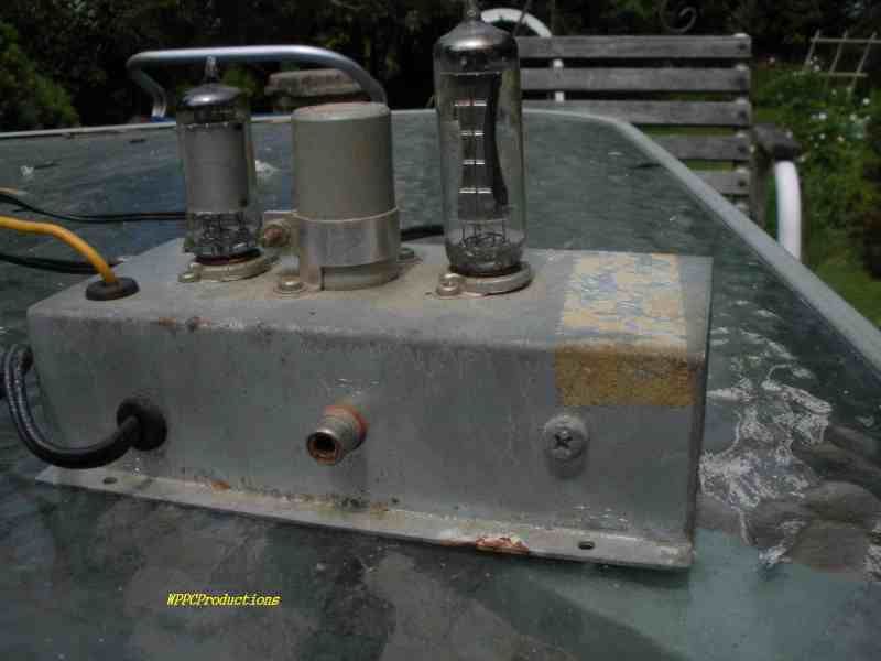

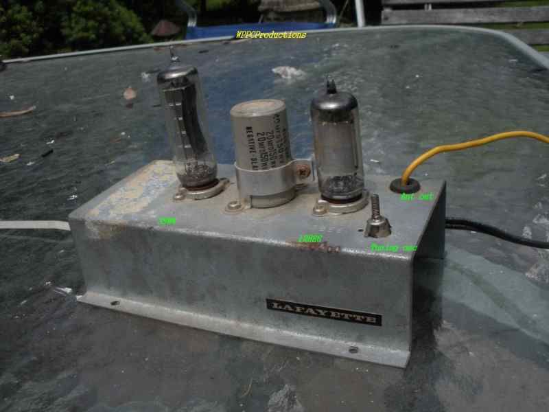

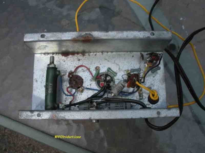

Hi All.I hope this is the right forum for this .Mods can move it to the right forum. Ok I have here a Lafayette two tube am radio transmitter.It still works.I tryed looking everywhere on the net for info.but coming up with zero info.Photos below.Tubes are 12BE6 and 35W4.Made in Japan.The caps look like probably the mid to late 1960's.
Top Front
Bottom
Back with audio input.
By looking at it .I don't know if this was a kit or pre-made.There is no model numbers on the rig.It looks like it came off.

Since the sockets are secured with screws it's probably a kit, no doubt a version of the 30s phono osc that are prone to FMing & weak modulation due to the remote cutoff 12BE6 used... It's far from a stellar piece of equipment...
Since it has no power transformer it's potentially dangerous, if you plan on using it it should be recaped and verified the input is isolated via a cap from the AC line...

I had an even uglier Lafayette like that in the early 1960's, every connection was exposed, and the top-mounted ballast resistor got hotter than the tubes. Terrible performance.

I see that your 35W4 is the one with the Jane Russell plates, sought after by tube audio aficionados for its sultry sound. You may want to advertise it on eBay.

Yes Bob The 35W4 .Isn't she cute.Thanks for the tip.

The 12BE6 and 35W4 are 7-pin equivalents to the 12SA7 and 35Z4. The honker resistor you see underneath substitutes for the "ballast tube" to bring the series filament string up to 120V. Note, there's more dissipated in the 'ballast' resistor than the heaters themselves.
