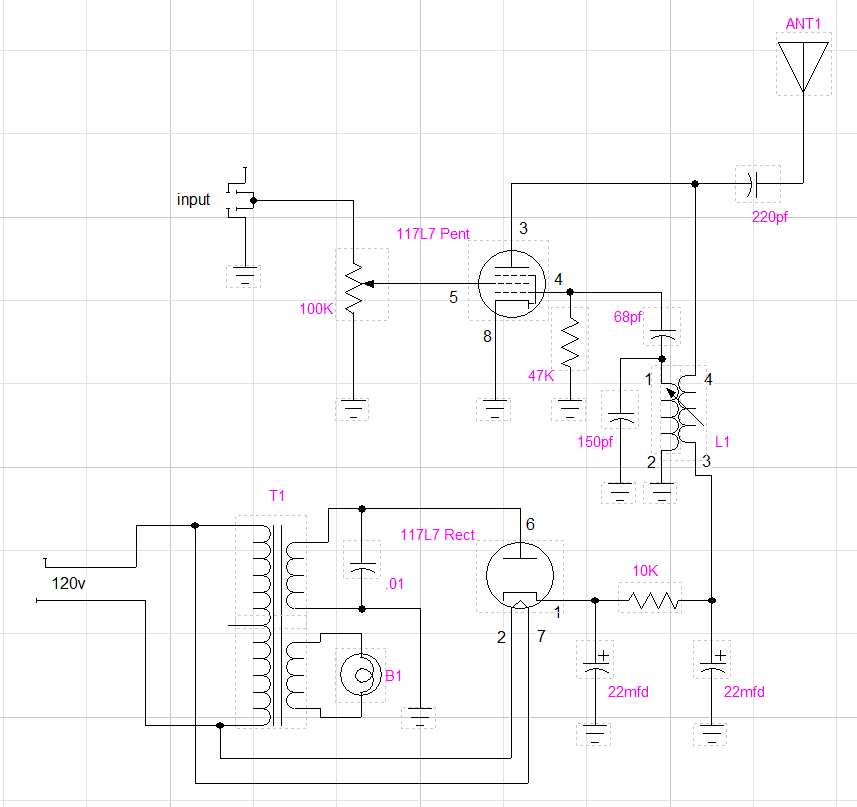

I just completed the Lil 7 Transmitter from the schematic on Phil's Old Radios website. It is working and has quite a strong signal. The only issue I have is I cannot seem to get rid of all of the heterodyning. I receive the signal around 820 on the dial. which is somewhat clear around here. No matter how much I adjust the slug in the RF coil or adjust the receiving radios tuning dial It's still there, not drowning out the signal, but there in the back ground. Is this just inherit with this circuit? Also the volume control on the Lil 7 only makes the interference worse the further it is turned. Best reception is from just on to about 40% of the rotation on the volume control.

Best reception location is generally at the upper end of band that is clear... If freq isn't changing by adj coil then the slug inside coil likely isn't moving...
The phono osc circuits are far from the best choices for building a homebrew transmitter...

The 'Lil 7 is typical of the phono oscillator type of circuit. It is a directly modulated oscillator. At low levels of modulation the signal may be satisfactory, but above about 30% modulation distortion products can become significant, including incidental frequency modulation, excessive sideband components (aka "splatter"), and harmonic radiation.

Well lets back up a bit, is this your transmitter??? If so add a .01 to .05 cap in series with input of gain(volume) control, strange results can be had with tube grid connected directly to input source, should be isolated...

Yes, that is the schematic. Well... drawn differently then the one I used but electrically the same. I finished soldered the terminals in the RF coil to eliminate that as a source. I then added a .01mF cap in series with the lead to the volume control center tap. No noticeable change. I still have a high pitched howl or screech in the background. This RF coil slug is VERY sensitive too. The output is strong and I can receive the signal up stairs, but the distortion is worse further away.
Another thing I find odd. I'm using an AM radio antenna made for my weather radio. It has a long lead with a bow tie end. The connection is an RCA jack. That's what I used in the Lil 7. Here's the odd thing, plugged into the transmitter the antenna does not work, it actually kills the signal, but if I use a jumper from the antenna center terminal tip to the SHIELD part of the female jack on the transmitter, it works just fine. The two points on the jack are not connected. Only to the center terminal. I'll post a picture of my construction.

If there is voltage on audio source it can effect the screen grid(G2), which controls tube gain... Without voltage it's going to be fairly weak but at least somewhat predictable... Far more difficult to modulate with even a volt or two applied... With the high input impedance I don't see a large value cap making a real difference... Adding a cathode bias resistor may help, problem is I haven't tried that on one of these so don't know if bias would improve operation...
Excepting that it had a preamp, Syl's 6BM8 is very similar to this unit... May want to look at it's cathode resistor...

With the filament wired to the line side of the power input, you better hope you never get a filament to cathode short.

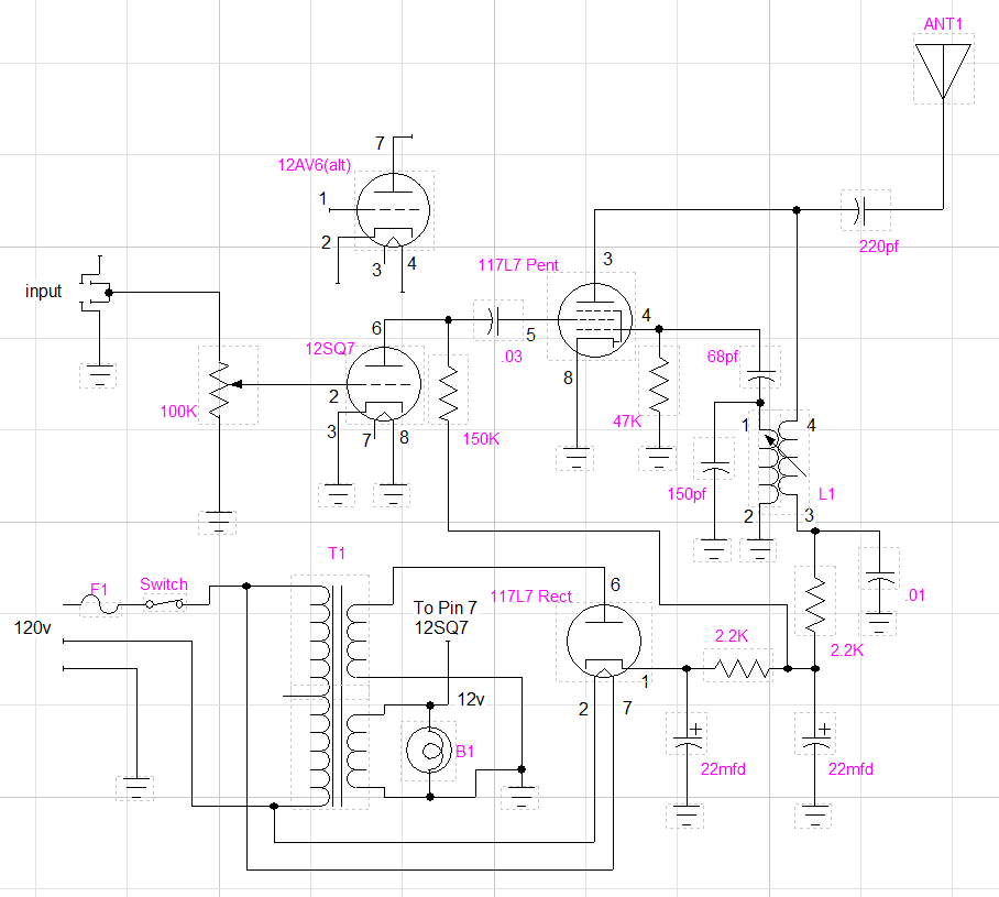

If you'd like to experiment with a preamp on the lil7, I drew a schematic for that as well(yeah the input cap was omitted when I drew it)...

It just occurred to me, it's the screen grid where the audio modulation goes in, and depending how the input capacitor is hooked up (or if it's missing), the screen is either biased to 0 volts, or is floating. You may get better performance by connecting the blocking capacitor between the pot wiper and the grid and then adding a resistor from screen to B+. I would normally use 10-22k but something that low might cause problems with the linearity of the volume control. In any event, you could try it, and if it improves things, you could switch to a lower value volume control.
(I'm referring to the original circuit, but the same thing would apply to 35Z5's preamp version.)

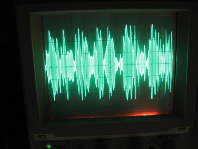

What happens with voltage on G2 is the RF output becomes far more efficient, signal will increase dramatically, but there is a catch... The extra RF means it requires additional signal to modulate the tube, without increase in audio you have a nice but almost dead carrier... Using just a single tube as audio amp, this is circuit that's needed to for modulation... Still, depending on tube used, screen voltage won't be more than maybe 15-18v... To really make screen modulation perform at higher G2 levels one would need audio circuitry similar to whats used for plate modulation... Of course that is pushing far beyond part 15 specs...
With just one stage of audio amplification very nice modulation envelopes can be produced...
