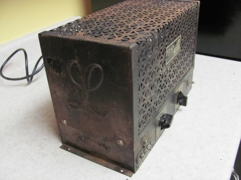

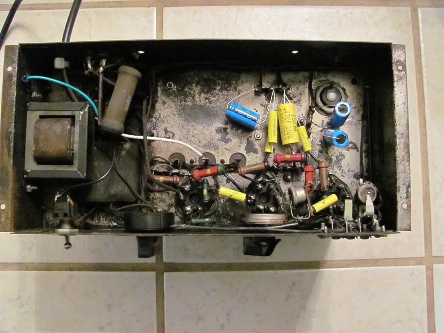

Hi all,
I picked up this amp at a radio swap meet a few weeks ago.

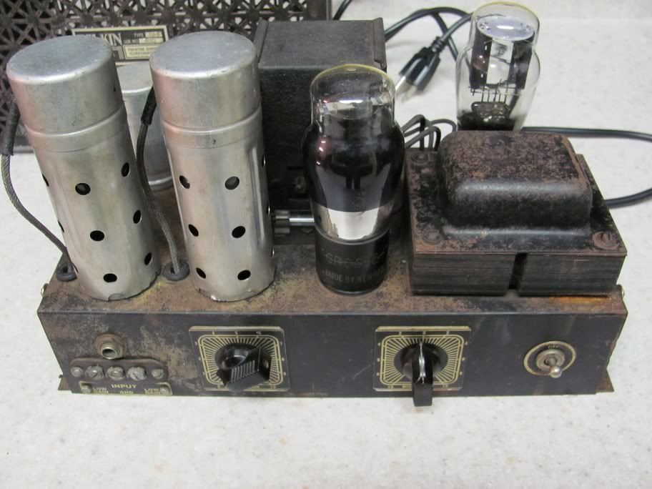

Got lucky! - The transformers, pots, etc were all good! After a recap and cleaning up some old tampering, the thing works pretty well. It uses 2 - 6C6, a 6B5, and an 83V rectifier. (It came with an 80 and that seems to work fine, giving a B+ of 360V.)

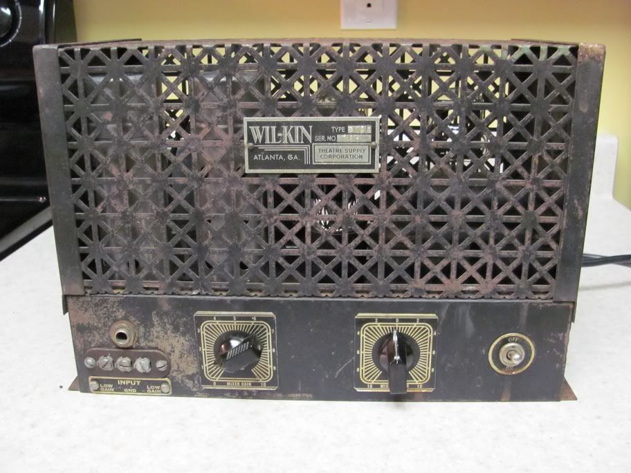

I am trying to learn a little more this amp. It is labeled by Wil-Kin Theatre Supply Co of Atlanta, GA. I've learned that Wil-Kin was incorporated in 1934 and not much shows up after 1942. They sold all sorts of theatre stuff, popcorn machines, etc.
I doubt seriously that Wil-Kin manufactured this amp, particularly with the big "Laverne & Shirley" L on the sides. Does anyone have any leads on who might have manufactured it?
BTW, this is my first experience with bias cells which are used on the two 6C6 tubes. They were dead, got them wet with some tapwater, now both are working at .9 volts. Is this the correct voltage? According to the 6C6/6J7 datasheet, about 1 volt would be a reasonable bias. If I were to have trouble with these, would it be a problem to add a cathode resistor for cathode bias instead of the bias cells?
Thanks Tim

Langevin comes to mind but I'm not sure their logo and Laverne's were the same font. Samples I could find, were not. They were also vertical rack-mount chassis, not upright-box.
James Langevin and James Lansing were peers at Western Electric at the time they spunoff audio.

Bias cells should be good for another couple of decades.
Must have had a really efficient horn as a single 6B5 can't do much more than 4 watts. Could have been a monitor for the projectionist room.

I believe that Wil-Kin was still around in the 1980's out of Charlotte, NC. They owned theatres at one point, too. I've never seen actual Wil-Kin badged equipment, and I've never seen the interior of a Wil-Kin booth at a theatre either.
I think this is a booth monitor amplifier, too. If it was mine, I think I'd go for the 83V tube to wake it up. I've always been a stickler for original equipment in my toys.

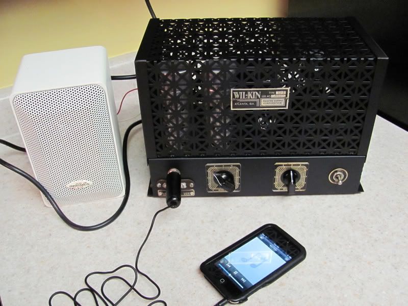

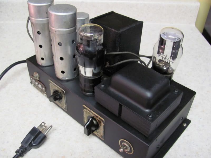

Well, it cleaned up nicely (plus a coat of Krylon satin enamel)
Although it's not high powered, it sounds nice and looks cool :D
Tim
