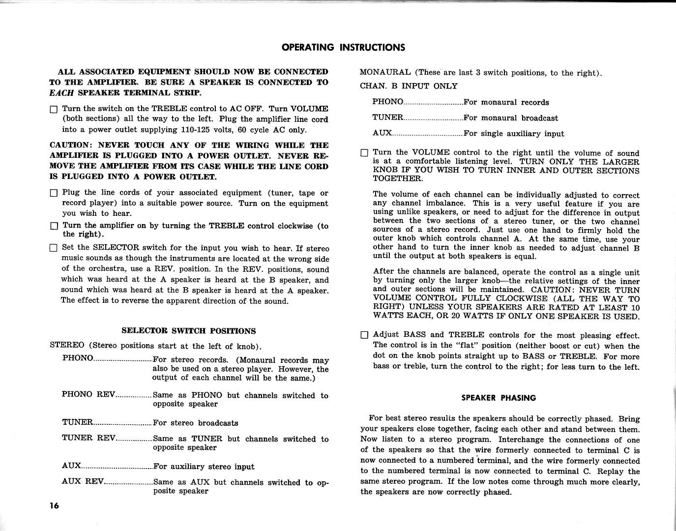

I managed to restuff the 5 section orange electrolytic capacitor on the kg-250 and all the resistors are within specs so I'm ready to try out the amp. The selection switch has me confused. There are 8 connections for inputs but I'm not sure how they match up with the switch. For, example there are 3 aux setting, two are aux and one is aux rev. What does the rev. stand for? Here are some pics.
Keith

This should explain it. Simply, one position reverses the channels from the other of the same input.

Thanks Don!!, That's exactly the info I need. I've got everything recapped and ready to go. I just need to find the time to plug it in.
