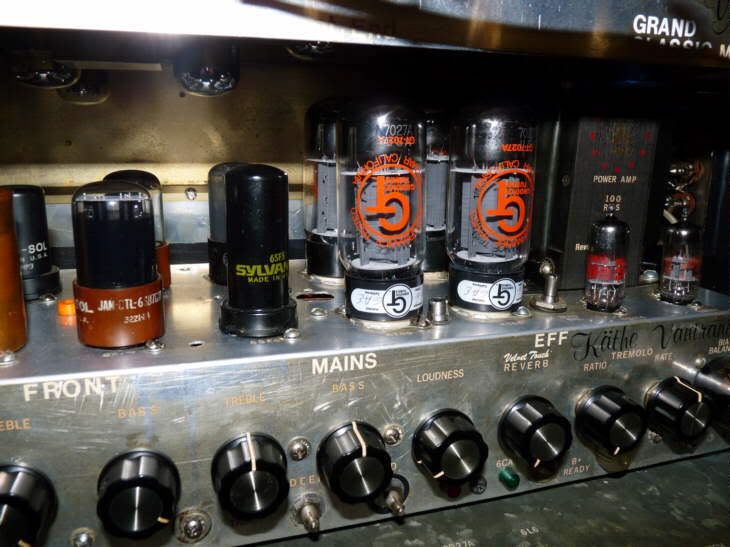

Some tardy holiday earnings were installed today for run-in:
I'd been after a set of these GT jobs for some time, and luckily the find coincided with the ability to purchase. These are NOS eighties-vintage Sylvania-made 7027A's, the first new OPT's in Bertha since the mid-nineties.
The set they are replacing (straight Sylvanias) goes out with over 600 hours, and they are still good, but I could tell the difference on instruments right away. 150 ma total plate drain with the old set coincided with roughly 180 ma with the new set. I biased them down to 150 ma total to conserve them as I did the old set.

Cold 807 time again for a 4-hour run-in.

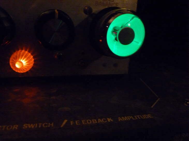

I was fortunate enough recently to pick up three bright 6AF6G eye tube spares for Bertha, which uses a pair. They might be worth a word here, since the type isn't nearly so well known as the 6E5 and 6U5, or even the 6AB5/6N5, 6T5 and the 1629.
The 6AF6G is a dual-shadow tube with independent control elements, allowing you to monitor two controlling voltages simultaneously. It has no control tubes built in. Therefore, the shadows read between zero volts (90 degree) and 160 volts (zero degrees).
You may add any control tubes you choose, sharp-cutoff, remote-cutoff, or a combination of dissimilar types (such as the 6AE6G, if you can find one).
With Bertha, I run one of the 6AF6's across a voltage divider to monitor the regulated B+ voltage off the #2 supply (power amp front ends). It is set so that 300 volts off the supply closes the shadow exactly.
The other 6AF6G is used as a bias balance indicator on the output stage, with two 6BN4 triodes as controllers. It is set for very nearly closed shadows at optimum bias for type 7027A's in Class AB1 service.
If the bias in the push-pull output stage tilts out of balance, the appropriate shadow on the 6AF6G will open somewhat (and the other will overlay to a much brighter green than the target).
Thus:
The tube is shown with the bias tweaked enough out of balance to show how the shadows appear if there is any significant balance drift. The shadow to the upper right shows underbias, and the one to the lower left shows overbias.
This kind of service calls for close attention to the 6BN4's, which must always be equal, or at least very near equal, in performance. My experience with them, however, is that if they start equal, it's typically quite some time before they begin to drift apart.
These 6AF6 eyes can be useful in many other services where standard eye tubes won't serve, or would only serve with difficulty in circuit arrangement.
