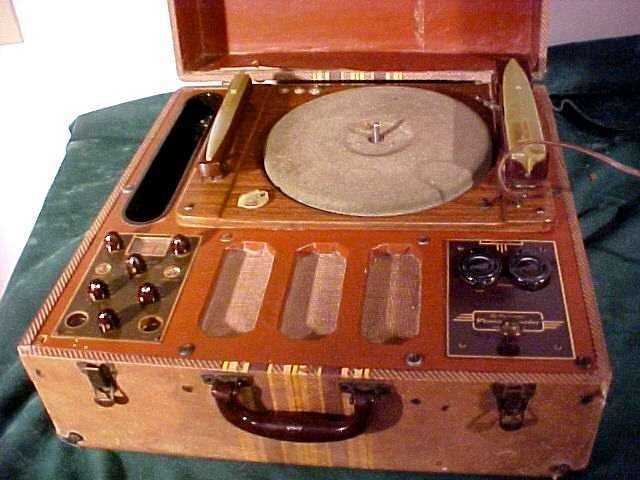

I also restored a post-war 8-C which blows away any of the others from Pilot, Howard, Granco, etc. I don't have a picture of mine but here's a picture of one I found on the web.
Waiting in the wings is a portable disc recorder/PA system/AM radio that weighs a ton. The recorder operates at 78 and 33.3 RPM. Looks like this.
