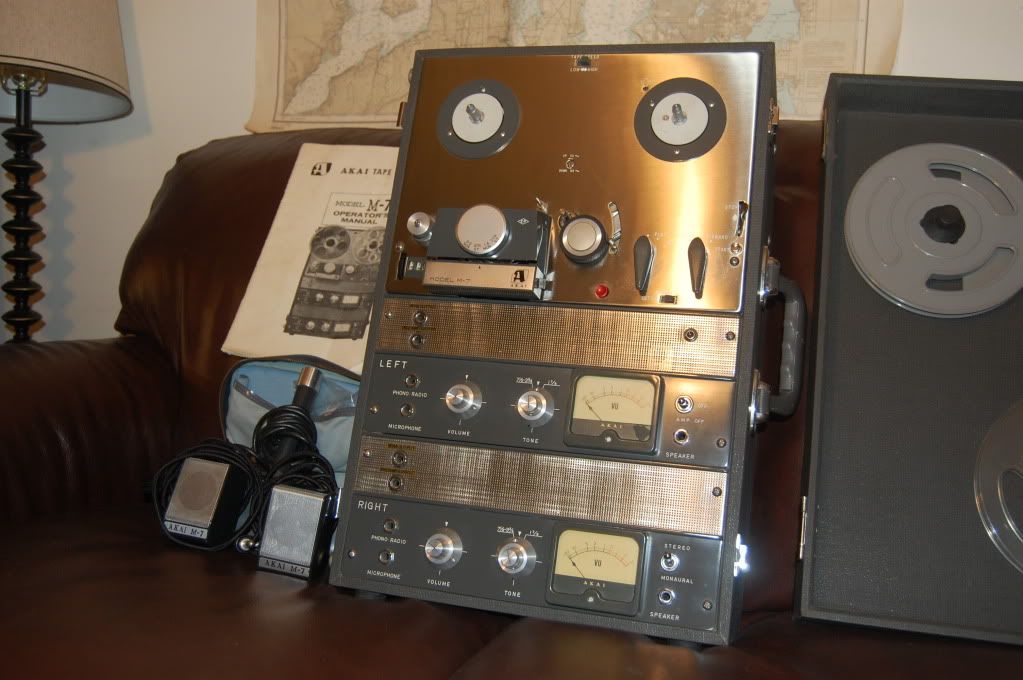

I picked up this Akai M7 locally from Craigslist. Originally bought in Japan by the seller's son. Has original manual, mic, mini speakers (not sure what the tiny speakers are for), tape splicer and splicing tape plus an ear phone. It's in good cosmetic shape but of course there is somewhite paint splatter on the case. We played it for a few minutes before I bought it. Both VU meters respond but the right channel didn't play through the the right channel built in speaker. Looks like I have a nice project, I'm looking forward to working on it and building a low power stereo. It's quite heavy, feels like about 45 pounds or so.
Sorry for the bad picture :
What do you think?

Nice.
Are those speakers or microphones?

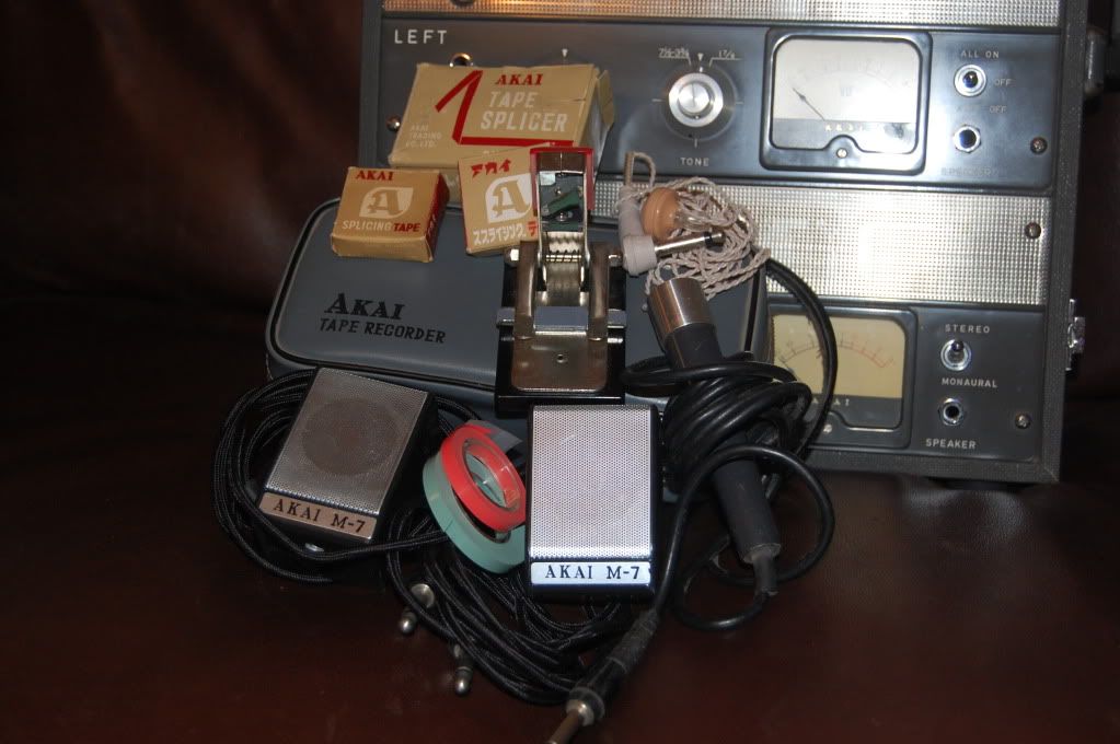

Those are two little speakers that fit in a small vinyl bag w/ the tape splicer and stuff. The little speakers actually have some weight to them. The Mic is separate and doesn't fit in the bag, it's betwen the small speakers. I asume there is a left and right speaker mounted in the cabinet firing upwards. I haven;t taken it out of the case yet to see for sure but it's a stereo unit so I guess therer is two speakers in the cab. . The shiny front part looks brand new. It's a thing of beauty.
Here in another pic of the accessories.

Akai/Roberts (US) were highly regarded in the mid 60s. Notice the strong resemblance to Ampex 600. It's not accidental. Nor is it a whole lot more than cosmetic. Ampex 600 was a portable studio machine. Akai/Roberts wanted to look like one and were even used as such. Until Akai got off on their gimmick tangent of crossfields and glass heads--neither of which did anything significant--their stuff was fundamentally solid.
But you don't have to tell your guests the gory details, it's a beautiful one of what it is. I've never seen the gold panel color but I've only seen the US/Roberts version

It's not gold in color, that's just the flash in a poorly lit room. It's just a nice shiny chrome color. I'll take better pictures when the light is better. The manual l is in English, but there is also half pages within that are written in Japanese.

Those two "mini speakers" that say AKAI M-7 on them, are actually microphones. I used to have that same model recorder, and the same microphones myself. Unfortunately, by the time I got mine, the tape recorder heads were too far worn down to do much good. Contrary to what "arbilab" says above, the crossfield gimmick really did work. It extended the high frequencies that went onto the tape, even at slower speeds. Akai was not the only manufacturer to use the crossfield method, as Tandberg had some models that used them, too. "arbilab" is correct in saying that the Ampex 600 series is essentially superior to the Akai. Both are built like tanks, but the Ampex is a better designed machine, and one used in some studios. The Akai was built for the consumer market, the Ampex for the consumer and semi-professional. The real professional studios used Ampex 300 series machines. Those were the work horses of the day.
I'm not too sure about those glass "GX" heads that came in later models. Supposedly, they lasted longer than regular heads because they were made of a harder material.
Anyway, there is only one built in speaker in the M-7. I think that they sold a separate speaker to use for this recorder, although I never actually saw one. The built-in speaker only works for the left channel audio. You need to plug in another speaker to the right channel speaker plug on the front panel.

Thats' sgood information JohnS, about the built in speaker., thanks for that. I checked the paperwork, it lists it at 47.3 lbs so it should sound pretty good. For the record, the accessory case is made of rich full grain cowhide not plastic, nice touch.

One thing that I noticed on your accessory bag, and that it says "tape recorder" on it. Mine said "terecorder". At one point, Akai changed the word "terecorder" to "tape recorder" on this model. I'm not sure where they got the word "terecorder" from! Perhaps a translation problem, or it was an Akai trademark? Anyway, the word "terecorder" never caught on.
BTW, earlier Akai's used the word "terecorder" on them, and that's why I think that your recorder is a later model.

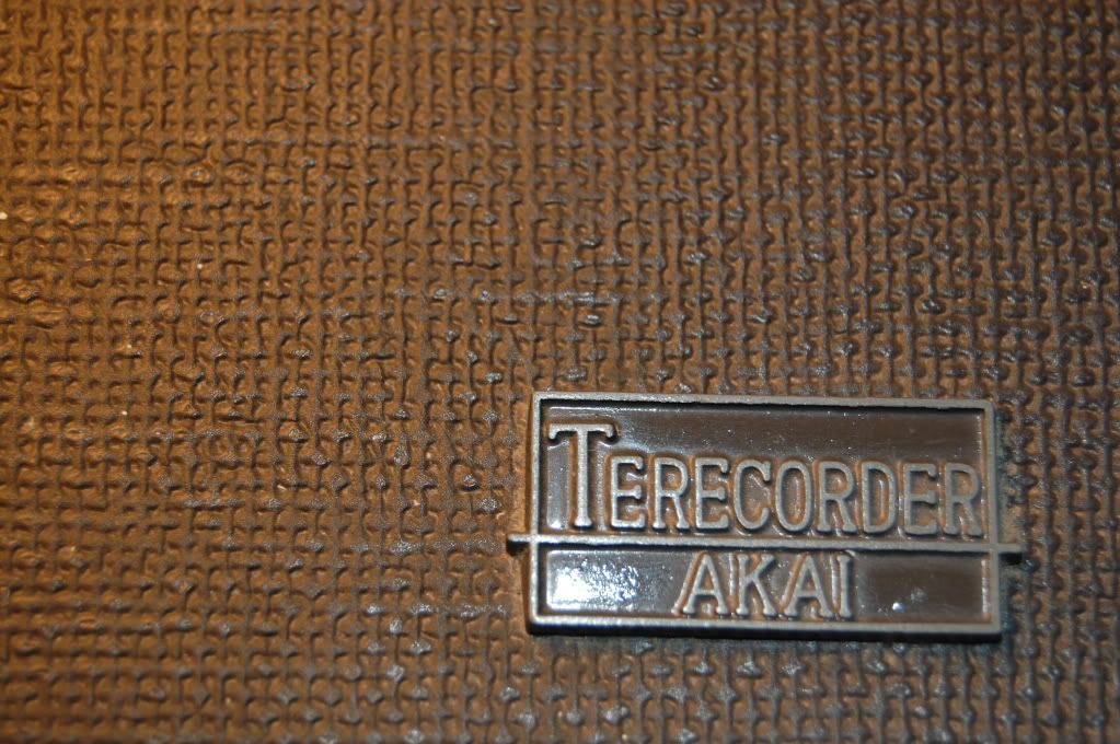

Here is a close up from the badge of the case, looks like they were still using the term when mine was made. I'm impressed with the quality of the case and woodwork.
I was gonna' say, those resemble the boxy, small speaker looking, Wollensak mics:

I feel dumb I thought those were speakers. The seller told me they were extra speakers and I just thought, leave it to the Japanese to make them that small.
