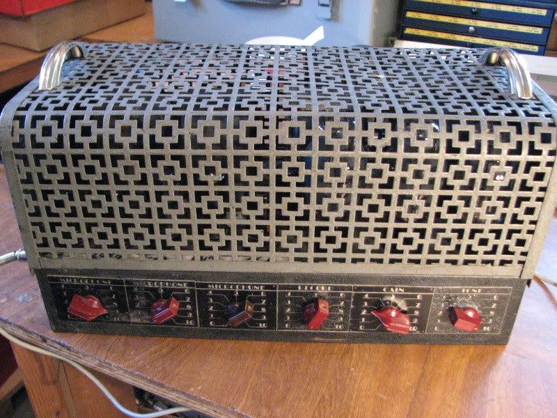

Here is the amp with the cover it came with. Would you not think it was a factory made amp having a cover like that? I called my customer and told him what comments I received on the ARF and he thinks rather than spend any more time on it, to just scrap it for parts, the 6L6GC are not cheap and after all, he got it for nothing.
I don't see any point in re-capping when you know the wiring is messed up, etc.
I do greatly appreciate all the suggestions and information you all have given, which I hoped would help solve the problem, but without a schematic, it's hard to
trace out a problem, not even knowing if the tubes are in the correct sockets and the correct tubes used. -- Thank you all again and if I figure out anything else, other than return the amp, I'll keep you informed. --- Thank you again. --- Ed.

Most definitely factory built unless it was a kit. Not homebrew unless the original owner had access to machine ship tools to form the top cover.

Pity you don't have some old radio distributor catalogs to browse around in.
Several companies, Bud and ICA among them, sold amplifier foundations with covers like that. Allied Radio sold them for years on end, and so did any other distributor who sold their product lines. I'm looking at a Bud-manufactured near-twin to this foundation in the 1954 Allied catalog right now.
Several companies made control dial plates (Mallory and Croname among them), and the distributors sold them along with the foundations. If you look at the dial plates, you'll see that they're not made in a single continuous strip. There are seams with occasional offsets between each plate. The seam between mike 2 and mike 3 is the most obvious one.
So, now that I've seen the cover and got a square look at the controls, I'm prone to agree with Battradio@ that this beast is a homebrew. I'd still date it somewhere between 1938-48. Those slope-shouldered transformers are antediluvian.
It'll still be good as a foundation for a rebuild; some of the iron may still be good, but I doubt that all of it is.
Keep us posted, Ed, and good luck...

Here is a Thordarson amp manual . they sold parts and chassis , see the similarity of the lay out . Chassis with cover like that with cover were a stock item that could be purchase .several companys sold partial kit , UTC and Stancor are a couple .

[quote="BigBandsMan"]I agree, typical microphone and phonograph amplifier, somewhere from late thirties through late forties. No idea of the manufacturer, but most of these amps followed the same basic themes.
Whatever the make and model may be, I think someone has scrambled the tubes. The current lineup (and those are 6N7 tubes, not 6SN7's), doesn't make any sense to me.
Larry, You are so right, my error, the 2 tall metal tubes are 6N7's. Don't know where my mind was when I said 6SN7)

More than likely the tube lineup should be
6SJ7 6SJ7 6J5 6N7 6N7(tube nearest choke) 6L6 6L6 83.
