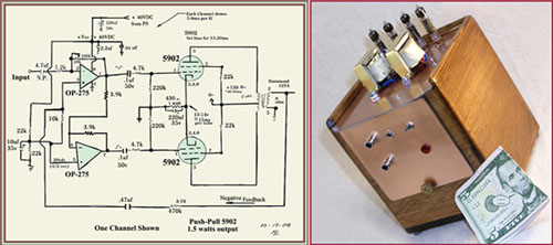

But I already have a sweet little PP5902 home-brew I built last year that i love:
Do you remember seeing the thread for it here on ARF?
(pages 4 and 5 show final drawings and completed project)
http://antiqueradios.com/forums/viewtop ... 3&start=80
