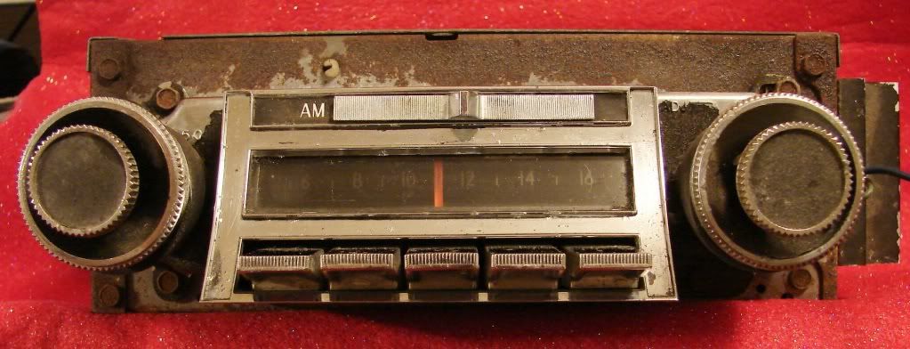

The number originally started with 729 and could not make out the rest.
It looks like the Buick or Riviera radio for 66 with a similar bezel however it does not have the multiplex socket. It is not stero and has a fader. Also the antenna trimmer is above the the tuner control. Checked with MAG and still could make no sense of what it fits.
Anyway here is a picture.
billn

Are you sure this a factory radio? Has the cheesy look of aftermarket.

I have a '66 Full size Chevy AM/FM that has a similar sloped bezel but isn't same(it does have the MPX socket)...
It's defiantly mid '60s GM and probably Buick, but just what model I dunnno...

It has a Delco sticker on it that's obliterated. It started with 729---
Hoping someone will be able to identify it.
MAG mentioned it may be Canadian.

I can't see the rest of it. Not seeing Delco one the dial plate.

had four '66 Wildcats years ago. That's a DELCO.

That's a Delco radio. Did Buick have a multiplex adapter like Chevrolet did for '65-'66? My experience in those years was with Chevys and Pontiacs. While Chevy had Stereo, Pontiac did not until 1967 in the full size cars.

That radio looks very much like that in the '67 Buick Riviera, except for the knobs. In '66, as asked in the O.P., the knobs might be correct. It could be from a '66 Buick. The curvature of the dial face looks about right, too.

Curiosity got the best of me. Last night I went thru my original Delco manuals. I do not have the 1966 model year handbook, but I do have the 1967. This is most definitely a Buick Riviera radio. It looked just like the one pictured in the '67. So this is either a '66 or a '67 model.
If it still has the original DELCO output transistor mounted on the heatsink on the side of the case....what are the numbers. It should be a Delco DS-501 with a date code below it. This would tell the model year based on the week/year of the transistor.

First off, this is definitely a Delco AM/FM set, and it certainly looks like it fits a Buick Riviera.
Some Delco radios were AM/FM mono. Others were "Stereo ready" with a DIN-type connector for the multiplex unit, and if the multiplexer isn't there, a dummy plug is installed. However you seem to be in doubt of its authenticity because of no dummy plug -- forget it; there WERE AM/FM mono radios. Believe me, I see plenty of both.

Unless the knobs have been changed, it would have to be a '66 because the knobs on the '67 are very different. All chrome and more rounder. Hard to describe, but very different from those knobs.

Incidentally the original DS501 has the numbers ( a small 6 and then 603).
So as you suggest a 66 Riviera radio?
