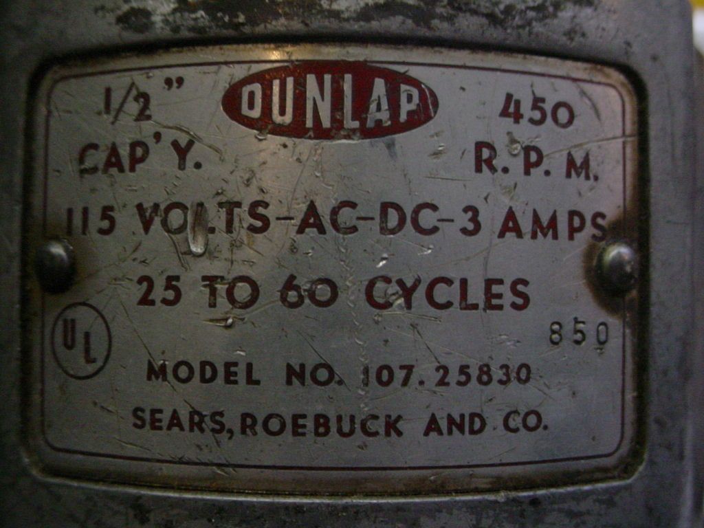

Is there any way I can obtain another on/off switch for a Sears Dunlap 107.25830 drill motor? It has a 450 RPM 1/2 HP 3A motor. Thanks.

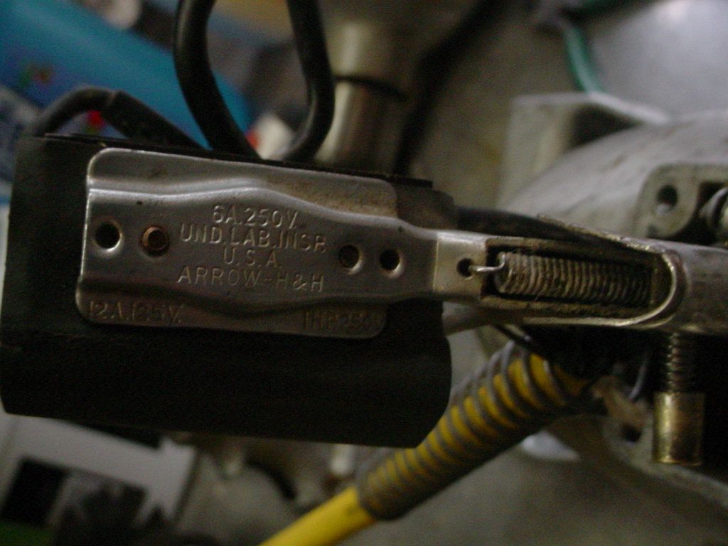

Did you have any luck finding a replacement switch? I have the exact same drill and I need a switch and it appears to be an Arrow H&H. Any assistance would be appriciated.

Thanks for the reply. I checked epay yesterday before I made this posting and found one but it was a slightly different model. I will continue looking to see if one pops up. I really hate to toss this drill motor as it is much more powerful than any 1/2" drill sold today. When I disassembled it yesterday all the internals looked good and the carbon brushes have a lot of material on them. I lubed everything up and jumpered the switch for a test run and it runs like new.

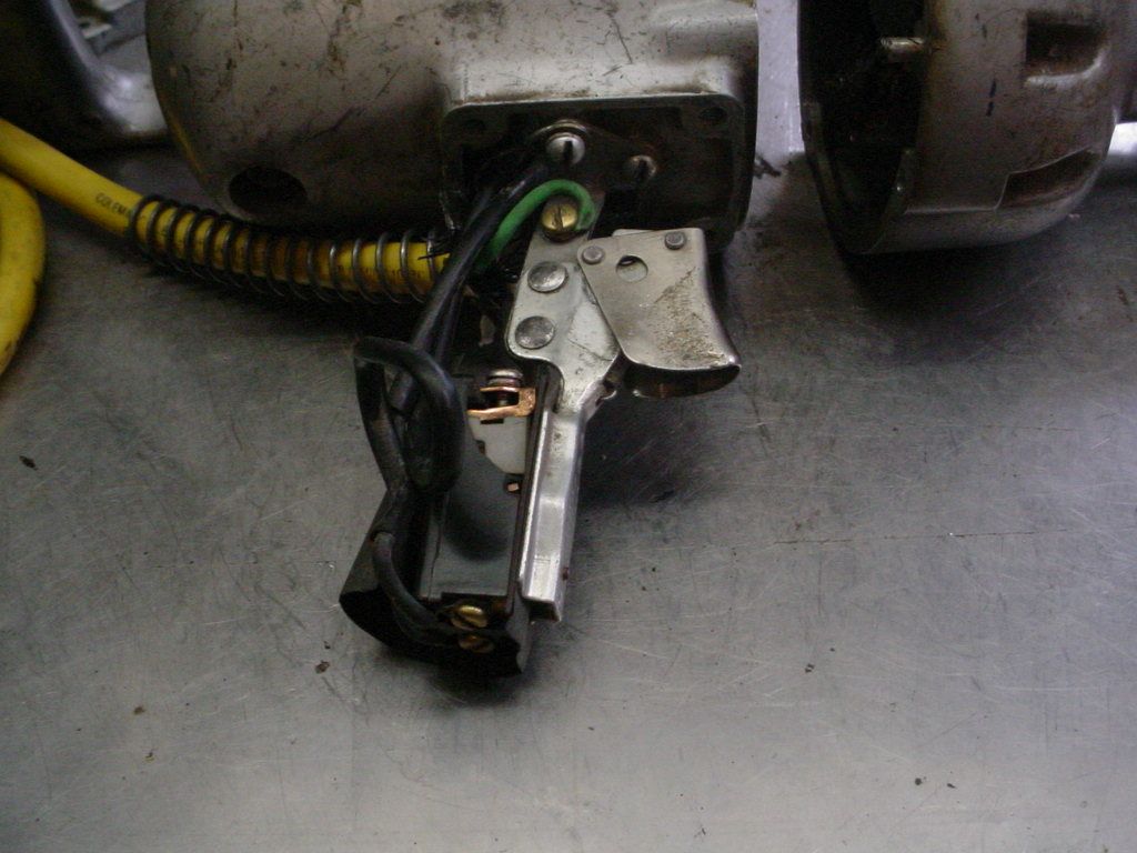

You might want to check the, or add a, third wire ground for this drill, with its metal housing, if it don't have one, since, the insulation on a 60 year old drill motor might have some leakage.

Yes, it's highly recommended that you use a grounded cord with this particular drill motor. When reinstalling the pistol grip, it might be easier to snag the trigger lock with a somewhat stiff monofilament wire, and then lead it into the grip.

I agree with the ground wire. I replaced the cord on this drill about 25 or so years ago. At that time I did add a ground wire as seen in this picture.

I did not find another. I was able to repair my switch to working order.
