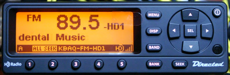

to test it I threw it on my bench and hooked it up to a 12 volt power supply. although it has an interesting way that it has to power up.
There are 3 wires Yellow, Red, and Black. You hookup the Yellow to a constant power source, the black to ground and the red to a power source that is switched.
To get it to power on I hooked it up with black to minus, yellow to positive, and then used an alligator clip to connect red to positive after the yellow was connected. If you do not do it this way the unit will not power up from the display.
Audio output is rather low but way more than strong enough for my homemade amplifier that has a 12ax7 input and single ended 35c5's for output. I have to turn the volume way down for comfortable listening. There are no specs on what it's audio output is.
There are 2 modes of audio out, one is through stereo RCA connectors and the other is through RF modulation through the antenna output to any frequency in the FM band. I have not tried the latter.

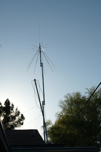

The unit is currently connected to a Discone antenna above my roof line.
FM analog sensitivity is excellent, I can pickup kcdx a 2700 watt xmitter 67 miles away (not HD) with a reasonably good signal. kvit a 10 watt station about 12 miles from me that is understandable (not HD).
FM HD reception is excellent for ALL stations in my area that have it. The unit takes about 7 seconds when tuned to an analog station to lock in the HD signal. Once locked in, the transition to HD is noticeable as the music quality improves, the noise floor almost disappears, and the volume drops slightly.
As for AM Analog sensitivity is excellent, kazg comes in great using either my discone or my 67' random wire antenna kazg is a 5000 watt daytime and 50 watt night time station. After sundown it still came in great and is 4 miles away from me. Most of my AM radios can barely get this station after dark.
There are only 3 AM HD radio stations in my area (that I could find). 2 are talk and 1 is a religious music station. 550 would not lock in after sundown even though it did earlier. The religious station locked in but sounded terrible. I think this is because of the recording quality of whatever they are transmitting since it sounded terrible in analog. The other talk radio station on 910 comes in very clear on HD or analog. Time to lock in seemed to vary for AM stations but was about 7 to 15 seconds. AM HD lock on was similar to FM with static and noise all but gone and sound quality improved.
When I first powered the unit on the audio sounded not very good with what I would describe as clipping or static, but that has since disappeared, and all stations sound fine. I have not noticed any compression artifacts in any of the Digital streams. After about 2 hours use the unit is rather warm, about 115° or so.

I turned the unit off for about an hour, and when I turned it back on the clipping/static returned (analog or digital) until the unit had been running for about 5 minutes give or take, then it disappeared again. :?

Brought the unit up cold this morning and it takes about 9 minutes for the crackling noise to go away. Its like sibilance or clipping, I do not know exactly how to explain it. If the volume from the station is low it is not there. After the nine minutes it goes away completely.
Here is the inside:
on the underside of the daughter board with the large chip on it, there are several tiny LEDs that blink rapidly at a regular rate.

When I switched the unit to AM the static crackling sound faded a bit over time but would not go away. FM was fine though. :x
Did some more testing and research on this unit, and found that these suffer with a problem on the RCA connectors of over modulation.
There are 2 fixes for it, 1 I have confirmed works and the other I have not tried.
The first is to use the FM modulation mode, I have not tested this. The other which I can confirm works is to connect the ground tabs of the RCA connection to the metal case, and on to ground. This is the only problem I have found with my unit. Once I grounded the RCA shields the audio signal cleared up completely.
PS. I bought another one at a later time and it has exactly the same problem and needed the same fix.

Yes it is a Motorola plug, I always called them "car antenna plugs". https://en.wikipedia.org/wiki/Motorola_connector
My unit has a folded dipole omni as seen in the picture below. The antenna under the discone.
I replaced most of the "coax" that came with the unit with the real thing.
