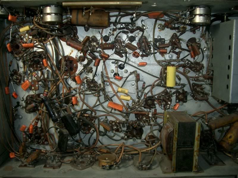

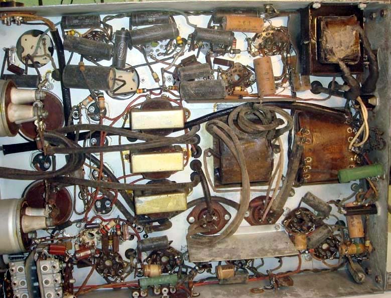

Ok here is the two chassis'
Audio chassis is completely recap'ed, notice the three large 2000 ohm resisters, thes do not show on the schematic! Also take a close look at the point to point wiring, it's all dry rot.
before
after
I need to do all the multi filters and those last three caps, still waiting for them to arrive.

I like the looks of a freshly recapped chassis.
I'm not a purist - I'd rather see Orange Drops and Yellow capacitors rather then those bland brown period correct capacitors. It looks clean and neat.
I see your TV is coming along nicely.

I like the space it opens up in the chassis, it makes other repairs easier to work on, your not reaching around the bulk that the old capacitors have.
