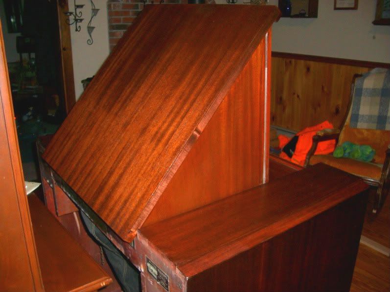

The wood veneer is really beautiful! The main cabinet is stripped and stained. I'll be stripping the flip up monitor screen tomorrow. I tried lacquer on one of the doors today and got some dimpling in the finish, I think the stripper is causing problems. I think I'm going to wash it down with denatured alcohol tomorrow and see if that helps.

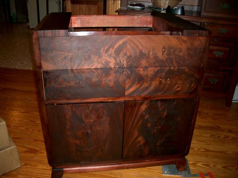

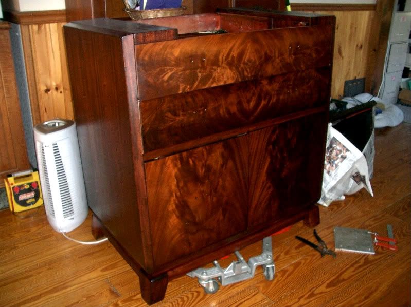

Well I gave up on the lacquer, Multiple cleaning and it still was riddled with fish eye so I gave up. Polyurethane when on like glass. I have 4 coats on everything and then run out. I'm going to let it set for a couple days, steel wool it and put on a couple of finish coat on Wednesday. This isn't the first time I tried lacquer, I just have never been able to make it work! :x I am very pleased at how it's coming along. the front panel are to die for! This is the most beautiful television cabinet I own. As you walk around it the grain actually changes!
Here's a reminder of what I started with...
Before:
after:

That will be museum or showroom quality when all is said and done.

The contrast from panel to panel is breath taking! :shock: Just looking at the work that went into creating the case, it's clear this was the top of the line for RCA in 1948.

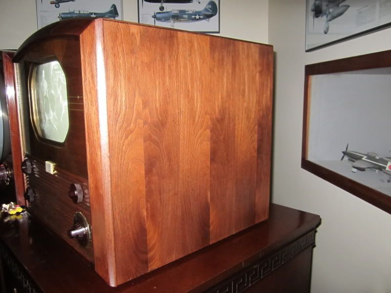

Lastly this evening is doing a test fit on the monitor hood.
