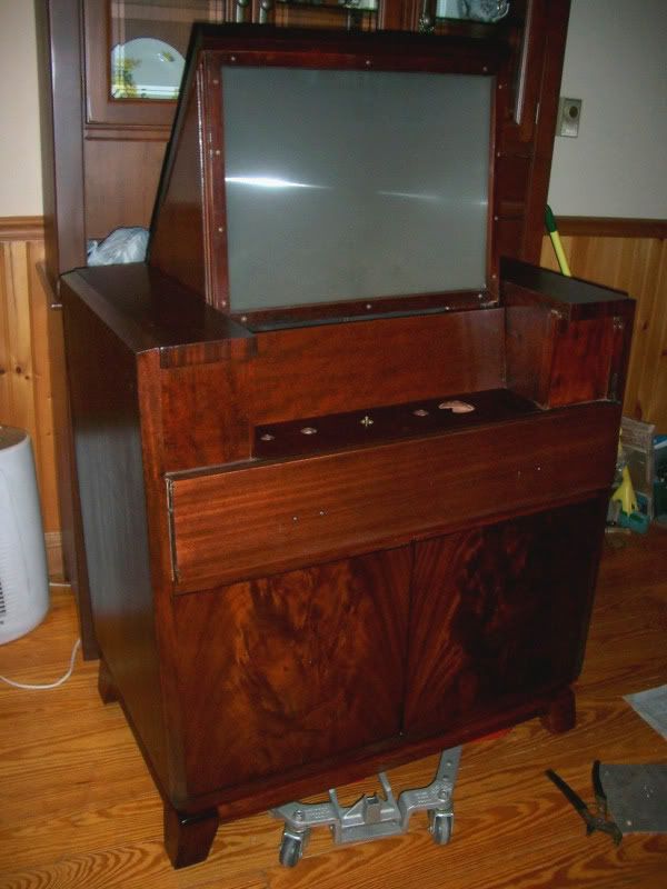

Here is a front view of the test fitting of all the cabinet components (control nook open on the bottom photo). This television will be quite the conversation piece when it's done.
Before
After, not too shabby for 63 years old. The plastic Fresnel viewing lens is in very good shape, no cracks or fogging.

I worked on testing all the tubes and cleaning their sockets last night as well as cleaning all the controls and checking to make sure they were reading correctly. Just waiting now for the caps and a High Voltage replacement cable to arrive, then I can start restoring the four chassis' in the set.
I am also starting to investigate re-silvering the mirrors. I'm holding off on that until I have success with restoring the function to the electronics. The re-silvering is going to be a hefty investment, no sense in putting a lot of cash into them unless the TV is working! I can't wait to see an image on the screen.
Steve

You do fine cabinet work, that set looks real nice.
I will be following with interest on how you do with the front surface mirror.
