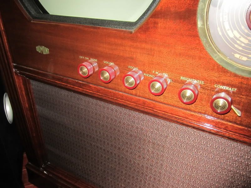

Had a nice warm sunny day so I took some better pictures. I really like the design of this cabinet, it just looks like a Juke Box to me.

There is a third way...Tung Oil:
It is a bit more labor intensive (more coats) but delivers a deep, rich finish when done. And, it's easily repaired/refinished. No matter how old it gets, if it dulls on you, just lightly wet sand with 1000 grit emery paper and glide on a thin coat with a folded paper towel.
That DuMont took about 15 coats, wet sanding between each 2 or 3, to achieve that mirror finish. It looks fabulous, as you can see. 8)

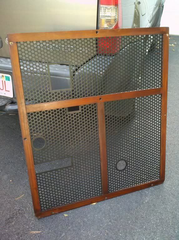

Before:
The biggest issues with the back screen was brocken off corners. I had to redo the dove tail joints on both side of the top of the frame.
Finished:
Screens are sanded, primed and repainted. Frame is also restained and ready to be remounted to the back of the set. It doesn't look like much in the pictures but it's a very impressive and large back panel on this TV. Avery good design to remove the heat from the set while keeping curious fingers out!

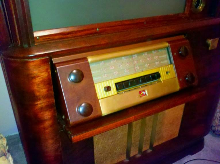

Before:
After: The odd discoloration in the speaker grill is the overhead light in the room casting a shadow from the radio door.

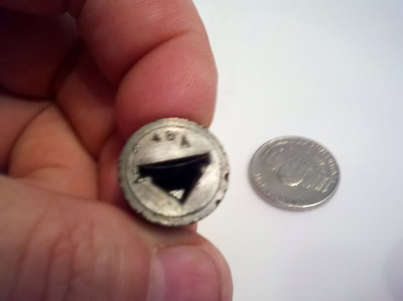

The radio is missing an knob. Does anyone have a spare knob they would like to sell me? PLEASE!!
The nipper logo is back lighted when the radio power is on, also each band of the radio has it's own light so as you sellect
different bands the back-light will switch row by row. I can't wait to see this effect on the first power up!
Better view of the preset chigago stations indicator area.
Man, I've been watching that through your thread - that monstrous thing that you are so perfectly restoring, only to be slowed down by that tiny knob! :twisted: Almost seems like the elephant & the mouse thing... :wink:
I wonder if you took some real good closeups of that other knob if someone might recognize it, or a possible suitable replacement, from within their collection?

Steve, post a better picture of that knob and give dimensions. I have a few that look close. If I have one, it's yours.
Actually I just looked and I have a couple that look very close but they are green, not brown.

Here's the knob. Good luck hunting, thank you for looking.
