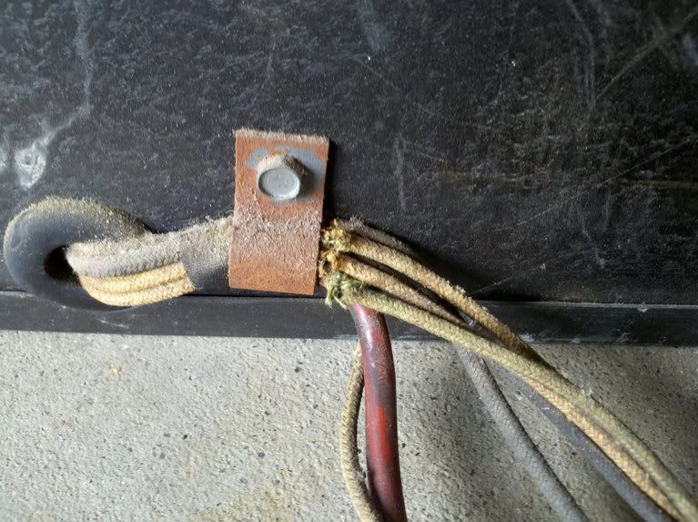

The electronics restoration begins...
Lifes disapointing moments :roll: As you can see from the following pictures I'm going to be replacing a lot of cloth wiring,
lots of dried out and frayed insulation! Anyone know of good sources for it?

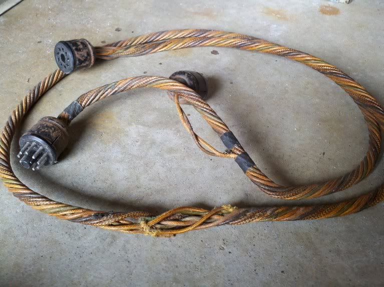

The radio/amplifier connector.
This is the CRT cables coming out of the HV chassis, more mashed up cloth wire to be replaced.

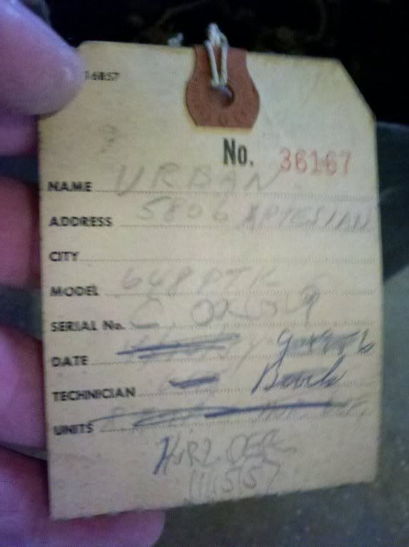

Most all of the chassis' had service tags on them.
The owner's info:
Fi Urban
5804 Artesian Ave.
Chicago Ill
648PTK
Last serviced 12/15/57

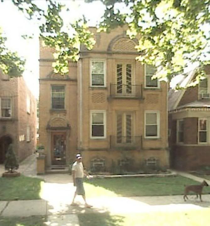

Well after doing some internet detective work, here's a picture of the 648PTK's original home.
It was built in 1929, owner back then was Fizal Urban. From the fancy appearance of the house
and the $1200 price tag on the TV set when it was new I'd say MR. Urban must have been doing well back then.
Steve

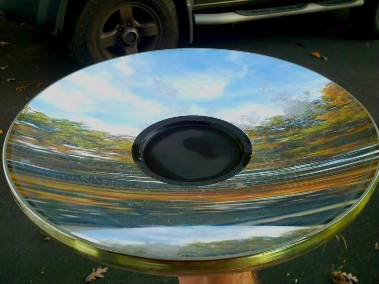

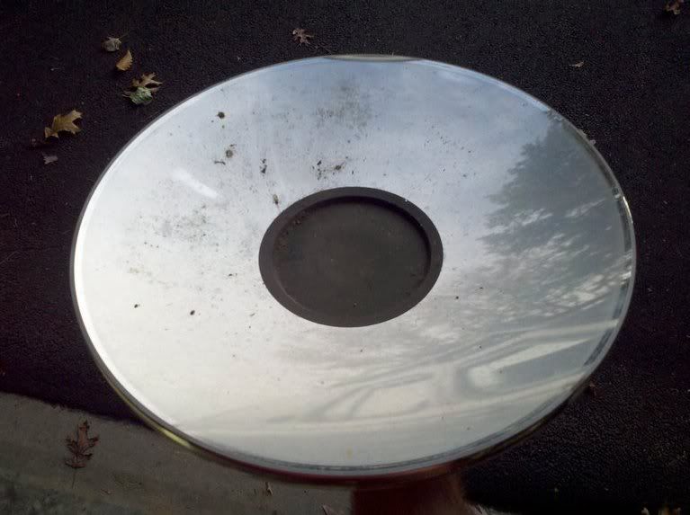

Working on the optics today cleaning and painting the drum. cleaning the main spherical mirror.
Mouse poop has etched areas of the silvering, at some point I'll send it out but for now it will work.
Here are some before shots of the mouse house.

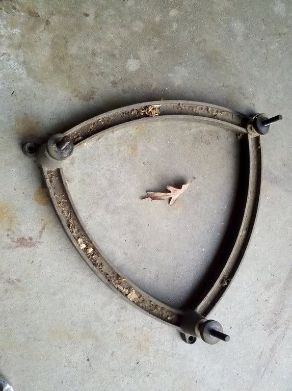

Drum tilted holder casting.
Dirty mirrorMouse Pee and Poo
Cleaned mirror, not perfect but it will work for testing once the electronics get powered up. In the upper right you can see the mouse damage etched into the silvering.

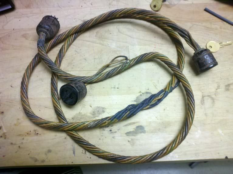

I worked on the main multi-cable today, not real pretty but it's electrically safe.
