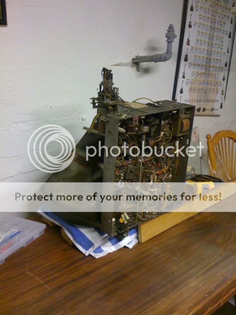

I have a similar set, here is how I have mine set up to begin recapping. Now all I need to do is get started with it. Hope this helps.

The inside of the yoke is a slightly larger diameter than the neck of the CRT so there generally is enough wiggle room to angle the tube above the bracket safely, though one could loosen the yoke rotational adjustment and maybe other yoke mounting screws to make the yoke free to move much more with the CRT, but I've never felt the need to loosen the yoke on my sets when removing the CRT (ether way it can't hurt as long as you can put it back together).
When I pulled the CRTs on my sets (this is going by a memory that is over a year old) I grabbed diagonally opposite corners of the screen. lifted high enough to clear the bottom retainer without scratching the CRT, and pulled the CRT towards me untill the tube was completely out of the yoke. Then once the tube was far enough out of the set I tiped it and set it face down on the carpet.
My sets used electrostatic focus CRTs. If yours uses electromagnetic focus you may have to remove the focus magnet or alter the procedure to account for this.
My process for rotating the chassis may not have been the safest.....And if adding wood etc. to prop it up sounds like a better idea to you, then by all means add wood or whatever you believe will increase the safety. Zenith sets of this vintage here in the USA are not rare, valueable, or all that sought after so I was not so much concearned with safety of my previously mentioned sets as I just wanted to dig in to the restoration quickly, without much hastle. Considering that your set is more rare in your area and presumably more special to you then you should take as much time and care as you need to feel comfterable in preforming the restoration.
