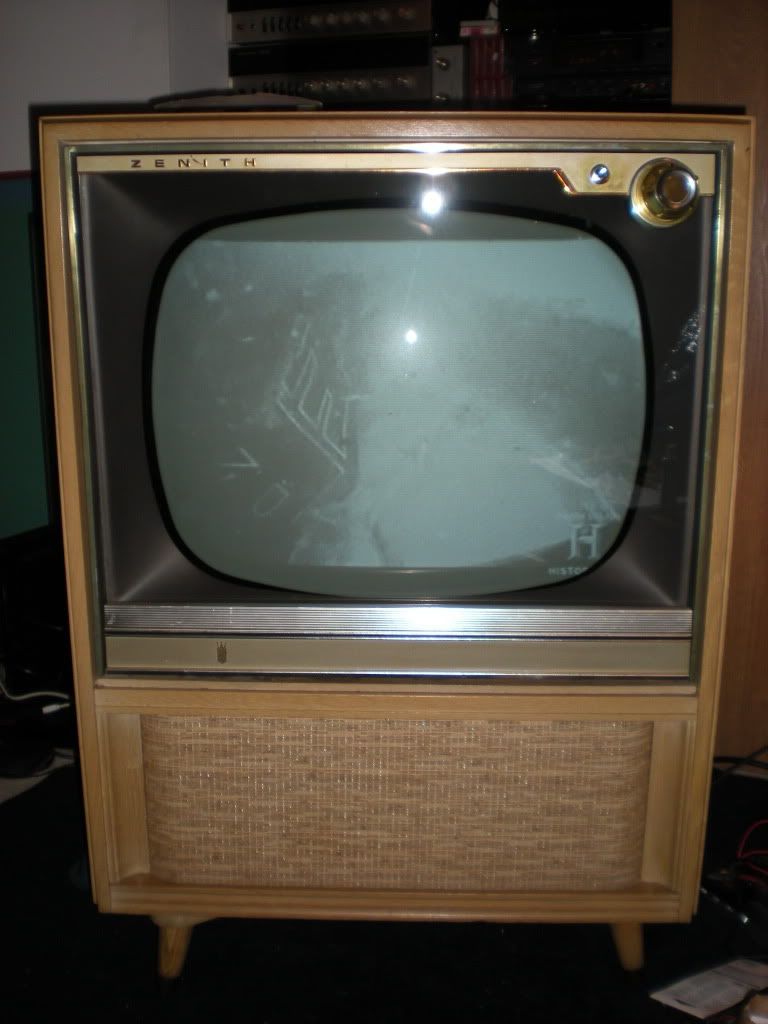

 Post subject: Re: Are Predictas more trouble then they are worth?
PostPosted: Dec Mon 05, 2011 4:03 am
Posts: 672
Location: Pewaukee, WI
Zenith had some nice modern styled sets in that period.
such as my 1958.
And 1962-64 portables.
It is out side the time period your going for, but one of my favorite (danish)modern styled sets is my 65' Philco roundy(bottom right).
There are some VERY stylish sets out there if you are on the look out. :D
Tom C.
