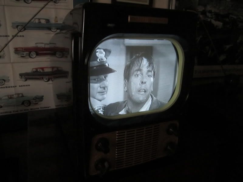

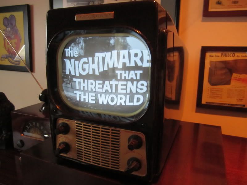

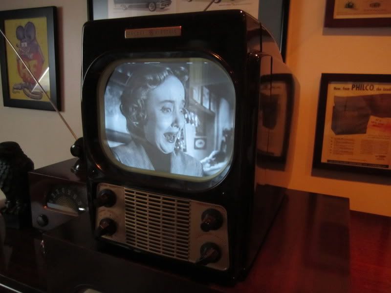

Every collection needs a GE Locomotive.
You have no choice but to comply...
Just ask Carolyn Jones:
"LISTEN TO ME !!!"
