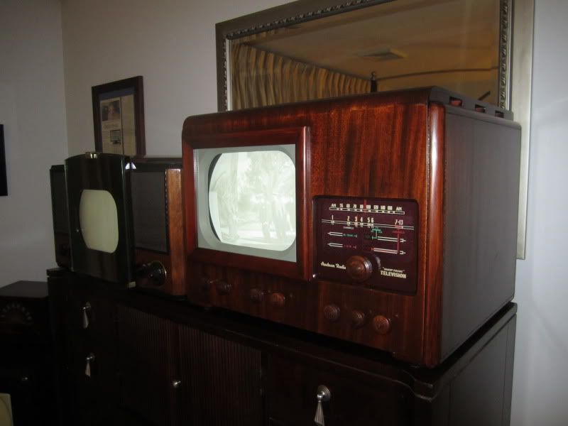

I can tell you exactly how I got hooked on this hobby:
I saw the following and immediately wanted a vintage TV like this:
Now that I had the "TV affliction", I started viewing ARF's obscure and arcane (at least it was to me) Antique TV forum. Read some threads but understood little.
I kept that picture of those mint Philco twin TVs and dreamed of owning one. I looked and looked but never could find a 1953 Philco TV. I really wanted a 1953 Philco and still have not found one. But later I saw these pictures on AuctionZip.com:
I went to the auction determined I was not going to be denied. And that is how it all went down - I got sucked in by those 1953 Philcos, and submitted to the siren call of that 1950 Zenith:-)
