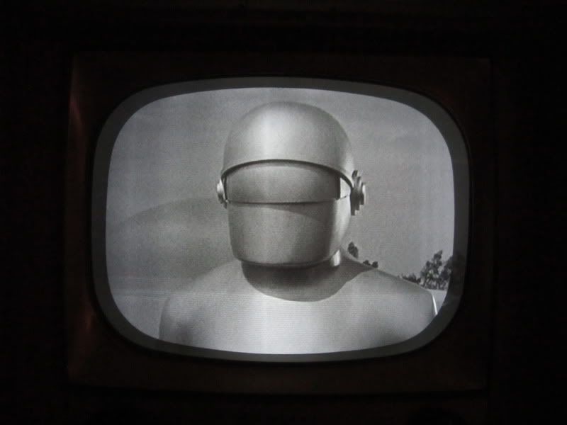

Dave, I just took 4 pics of the set playing so you can see what I'm facing. Upon firing it up this afternoon, the horizontal was VERY unstable; almost impossible to lock into sync for more than 30 sec.
Image 1 is a commercial, and you can see the lettering is cut off on the left, but the pic is stable.
Image 2 is a show on Amimal planet, and the Animal Planet logo in the top right needs to be over farther to the right thus showing the pic is centered too far to the left.
If I adj the horiz hold to move the pic to the right, it loses horiz sync. Turning it to the left slightly produces Image 3 then eventually Image 4.
If you look closely at Image 1 (commercial) you can make out the bar at the extreme right of the screen.
Doug

Three things come to mind.
You could have a tube making a poor and intermittent connection with it's socket.
You could have a tube with an internal bad connection.
You could have a resistor with an internal fault that causes the resistance to fluctuate erratically.
Try gently wiggling tubes with the set running and see if wiggling one causes the sync to jump around.
Then try gently tapping tubes with a plastic screw driver handle and see if that causes the sync to jump around.
Get some freeze mist (I think that Radio Shack may carry it) and cool down the resistors and other parts looking for a change to the sync.
