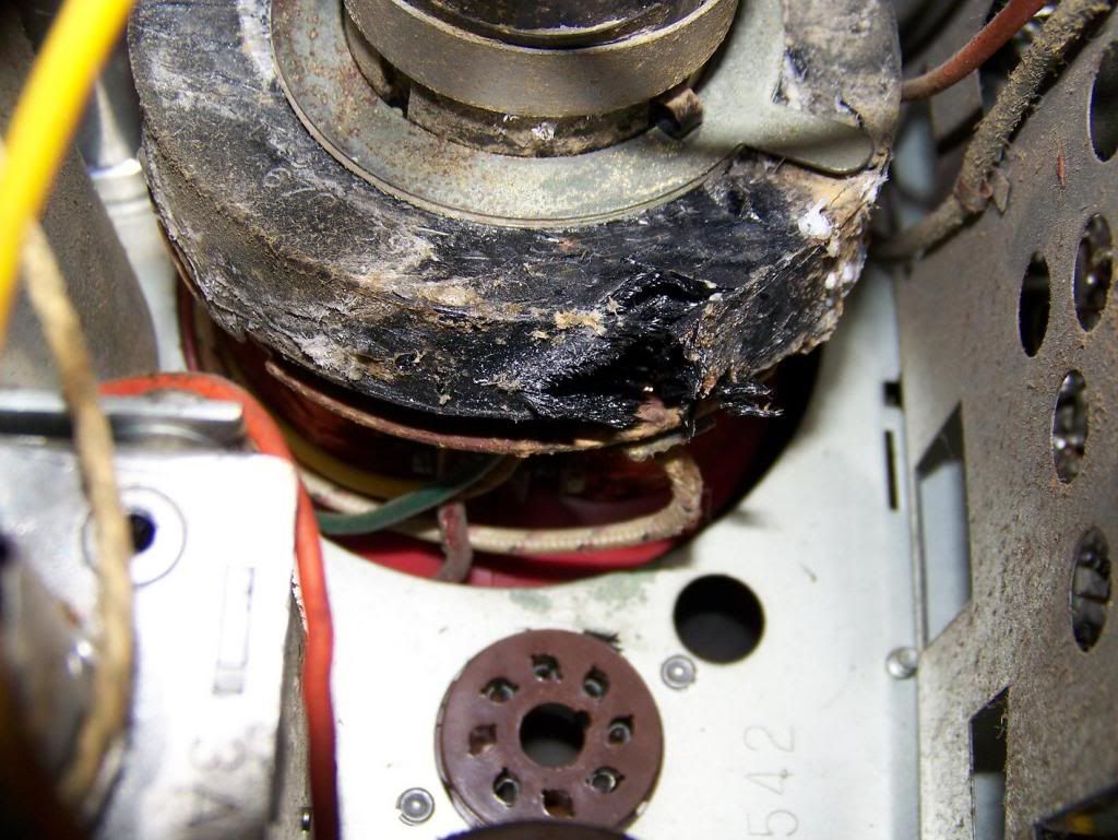

Anyways when i had it open i also noticed this nice burn
Anything I should really worry about with it?
 Post subject: Re: 1958 RCA 14" Deluxe 14-PD-8057D
PostPosted: Sep Fri 20, 2013 6:10 am
Posts: 9952
Location: Redlands CA
It's not really a burn, it's a rotted yoke cover, very common on sets of that era.
It's worse in the one spot because the heat of the tube next to it accelerated the deterioration.
Nothing to worry about as long as the cover still holds the yoke in place.
