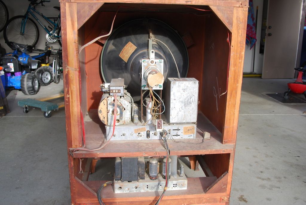

I picked this up in March of 2015 and finally have time to work on it. Pretty dirty and dust on the inside but should clean up well. Here are a couple of photos after I picked it up last year and wiped it down with lemon oil:
The cage that covers the back was included. Just removed so I could take some photos.
I tested the 19AP4 CRT with my Sencore CR-70 and talked about that in a different thread. Here is a photo of the heater:
I read somewhere that if the filament glows blue like that then the CRT has lost its vacuum. Has anyone else heard of this? I hope not but if that is the case then fortunately I have a spare 19AP4 that tests strong.

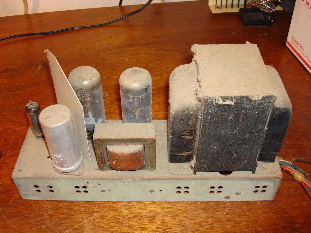

So my fist step tonight was to remove the power supply. As you can see it is pretty filthy:
I have an original Sam's Photofact for this as well as the original Zenith service data.
First thing I plan on doing is checking continuity on the transformer. If that looks good then I plan on stripping the chassis of all parts and coating it with naval jelly. Then repainting it.
I've done several radios but this will be my first TV. However, I've watched a lot of banderson's YouTube videos and have been reading about what it takes to work on vintage TV's for quite awhile now so I have a pretty good grasp of the basics and know where not tot touch so I don't kill myself. I also am a great admirer of Phil Nelson's site!
With work, a wife, 2 kids, and a house to keep up I have a feeling this is going to be a long restoration. Hope we can all enjoy the ride together.

I read on here once the blue illumination means the ion trap is correctly aligned. I think Phil provided that info.

I hate to be the bad news bearer but the ion trap location has nothing whatsoever to do with the blue gas conduction glow within your CRT.
It has leaked air and therefore now is "gassy" rather than a vacuum so it acts somewhat like a neon sign. Must be replaced in order to correct.

The photo is rather dark -----is that the CRT neck that is glowing or one of the 5U4's? If it one of the 5U4's then that is quite a relief and you just have power supply issues which are easy to fix.

You didn't say what the emissions were, if the emission and cut off is good then the tube is most likely good.
I have seen this blue glow in CRT's before, it looks like the same blue glow you get on some power tubes when they are under a load.
A gassy tube will glow down inside the elements (usually a more Lavender color), a good tube will glow on the inside surface of the glass, this appears to be on the surface of the glass and right where the opening in the gun is at.

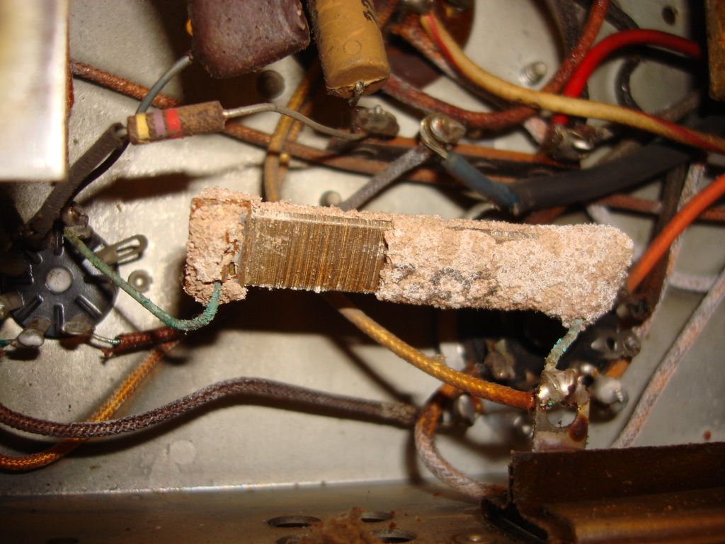

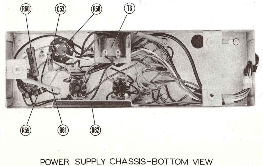

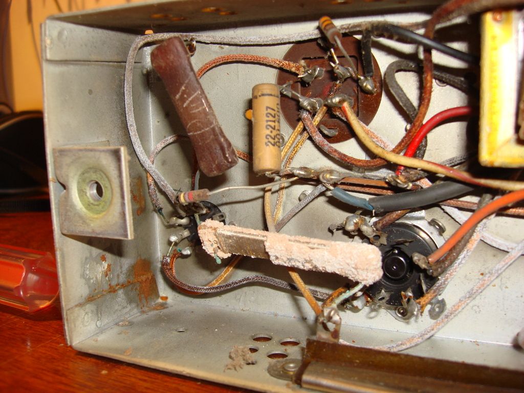

Interesting. Sam’s says this part is R61 (10K, ½ W resistor):
In the picture I took it looks a lot like a wire wound resistor with a higher wattage than ½ W. But the literature does not call it out as a wire wound. It does call out R60 as a wire wound.

Last time I saw that much blue around CRT filaments, the filament burned itself out within a minute or so.
 Post subject: Re: My Next Project - 1951 Zenith H2445R Tennyson Porthole
PostPosted: Aug Thu 18, 2016 9:59 pm
Posts: 5084
What does it measure?

I checked what Sam's is saying is resistor R61 and compared it to the 1951 Zenith Television Service Manual. The P/N for this resistor in the Zenith manual is R27. R27 is listed as a 10K but says that it is a 5W wire wound resistor. That matches the photo in Sam's and the photo from my chassis. So it looks like the wattage is a misprint in Sam's. I still need to measure the actual value tonight.
Regardless, the one in my set looks pretty crispy.

No doubt, the wattage escaped the editors. Maybe it interpreted as .5 watt by the typist? But 10 watts wire-wound makes sense. And that is an easy resistor to find and replace.

Also, I removed the capacitors and resistors last night. Referring to the picture below, R61 (wire wound) was open and R60 (wire wound) just crumbled in my hand. I did not test R62 yet. The others are just carbon comps so I'll replace them as a matter of course. Still need to test the tubes.

Also, as for that "Candohm" metal resistor that is mounted to the chassis R-62, you could get a good metal wire-wound replacement for it and attach it to the chassis (for heat sink purposes). They are notorious for the paper inside going bad and the wire inside shorting to the metal case. Actually, those sand resistors are rather inexpensive today and the quality that we have is far superior to what Zenith had available to them in the 50s.
