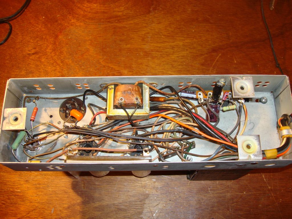

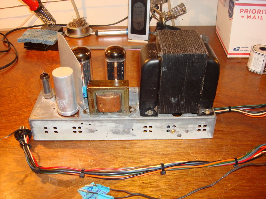

Been awhile since I've worked on this. The power supply has now been completely overhauled. I cleaned up the major rust spots and cleaned off the grime from the external wires. All caps and resistors have been replaced. Here is a BEFORE:

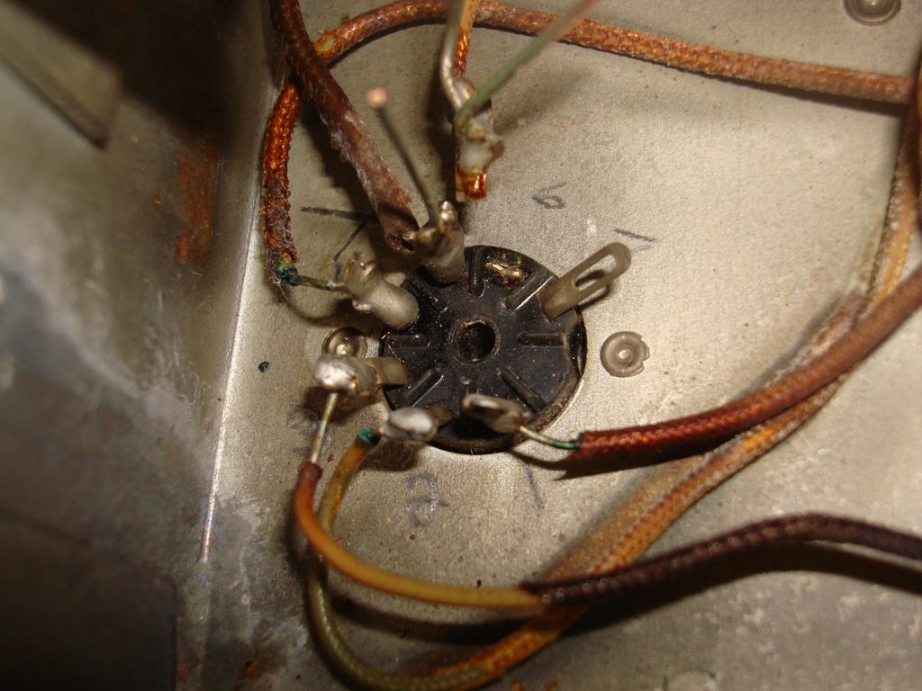

The #6 tube lug on the 6BF5 broke right off when I tried to desolder the connections. I had to get a replacement tube socket off of eBay.

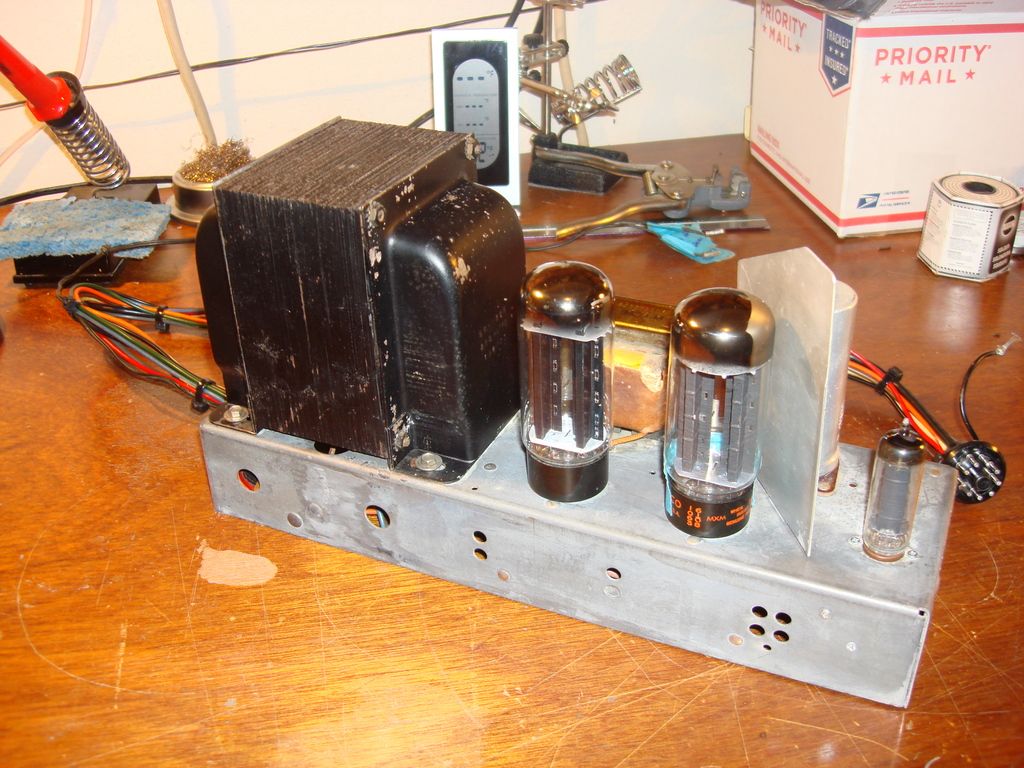

Now my biggest concern... the horizontal output transformer. It looks like all the black coating has melted off. Here are some photos before I dusted it off:
After dusting lightly with a small painters brush:
Also, it looks like there may be a wire sticking out. Upon closer inspection of the photos though it looks like some sort of wax that got melted and pulled away.

I have Thursday and Friday off so I'm going to test horizontal output transformer with my Eico 944 flyback tester on one of those days.
Can someone please give me feedback on how the horizontal output transformer looks? If it tests good, am I going to have to recoat it? What do people use to recoat these?

Looks OK to me other than that bit sticking out. If it's a wire that could be bad. I've used corona dope, and acid free silicone to recoat flybacks. Both work well but be very careful not to damage the fine wires. Looks like your yoke cover is made from the type of plastic that deteriorates over time. Common problem.
I've had good luck fabricating new ones from sheet styrene cut to shape and glued.

Yes, if it is a wire I'm not sure what to do. I just lightly dusted everything off and took some photos. It was getting late last night and I did not look at it any further. I'm hoping it is just a piece of melted wax or something hanging down.
When you recoat the flyback do you leave the original, crumbled coating in place and spread the coating over it or do you try and remove the original coating as best as possible? I would think the former since it may be risky trying to remove the original coating.
Great photos on fabricating your own yoke cover! Looks like I may have to do that, but I'm going to take this very slowly. One step at a time.

Thanks I carefully remove as much of the old coating as possible. You have an iron core flyback and yoke.

I restored the same chassis about four years ago, and my flyback looked just like yours does, including the loose wire. I found the wire after I was trying to remove as much of the coating as I could. I feared the worse, and was sure I had ruined the fly. Well, I tried the set and it worked fine with the wire just hanging there. I asked for opinions, and it was suggested that it may be for a secondary tap that was not needed for this particular FBT. Anyway, I recoated the tire with sensor safe RTV and it's been working fine ever since.
There are photos of all this in a thread that I made either here on ARF or over on Videokarma, but I can't seem to locate it right now :oops:
Good luck,

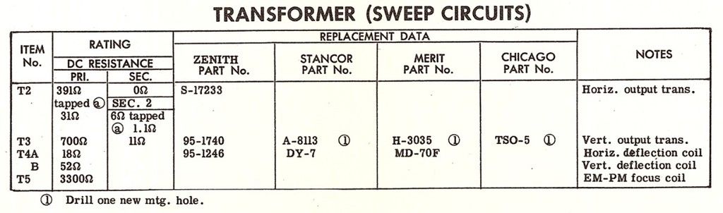

Might be. Here is the parts list from the Sam's folder.

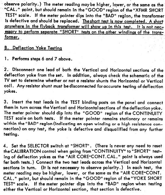

And I'm hoping someone can help a new guy to TV's out. I'm going to need help to understand how to use my Eico 944.
Zenith schematic only is here:
https://drive.google.com/file/d/0BzQx4c ... sp=sharing
The 944 instructions are below.
Step 2: It says to remove the plate caps on the High Voltage Rectifier and Horizontal Output tubes. Does that mean to revove the connection from the top of each tube (in this case V18, V19 and V21)?
I am at work and cannot look at the set but Step 4 says to unplug the deflection yoke assembly. I'm assuming there is a plug somewhere and no desoldering needed?
Step 5: Unsolder one side of the width coil. That's L24 where it connects to C83.
Step 8: Connect the leads across each winding of the transformer. For the first winding on the schematic that would be the top (plate) of V21 which was disconnected in a previous step and C83. For the scond winding that would be C79 to the bottom of C82 (assuming it is not shorted)???
Do I need to worry about testing at the taps? Do I need to test the L24 winding?
Step 9: Connect the two test leads to the two plate cap terminals coming from the transformer. Where is this on the schematic?
I'll follow up in a later post with questions about how to test the yoke.

An ohmmeter won't necessarily detect shorts in the windings. Yes, remove the caps from V18, 19 and 21. I do not know if there is a plug for the yoke in this model. Yokes are often hard wired and you'll need to do some unsoldering to test it. On the positive side they are usually fine - don't think I've ever encountered a bad one.
If you're going to go to the trouble of testing it, you might as well test every tap. The two plate caps in the test procedure are the ones on V18-19 (shorted together) and V-21.
