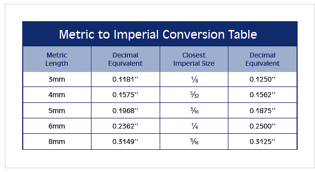

Never use a metal screwdriver. Make you own alignment tools by filing down some plastic chopsticks, or buy a set.
With ferrite tuning slugs...
In the beginning... If they don't move freely with a small amount of force... STOP
apply a few drops of alcohol/Zippo lighter fuel and jet some heat into the hole with a hot hair dryer or touch them a few times with a relatively hot soldering iron, or heat a finishing nail (held with pliers) and touch the slug.
If I'm not mistaken these are 4mm - 5/32" plain-slotted ferrite slugs, (cannot remember their length).
You will have to dig out the broken piece. Take your time.
If you have or obtain smaller ones, you can wrap some thread around them to make them screw in and out a few times. If your alignment is successful, apply one or two drops of hot candle wax.
Search ebay→ for ferrite slugs
If you are going to replace the capacitors in this radio, an alignment should be done last... :)

I understand about the screwdriver and did it anyway...Im so p.....at myself...they are a little smaller than 3/16 so you are right..probley 4 mm or 5/32. I have a piece and measured it...with a caliper and it was close to 5/32.
I took a core out of a tv and it was too large..so I filled it down with a ax sharpening stone..first I made 4 sides and made it like a square..then filed a little more on the sides until it fit..
I did get it to work but, I dont know about you, but when I repair something if its a possibility that it is wrong I will not feel good about it...and it eats at me..
You have any ideas who, or if someone sell's this part..
thanks for your help.......Kenny

I checked it with a micrometer and it is right at 4.5mm. or right at 0.1563 inch's
