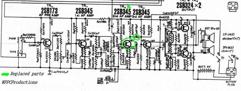

Hi Guys .I'm new here.I dont see no since starting a new thread on the same radio model.Is this ok.I dont want to be a thread hijacker .I have that same radio.The Radio work great.Playable with good reception .But it has a moderate hiss in the background on all functions.the hiss is still there when the volume control is to zero.I got the schematic online last night.but its not really clear to see the parts values .I'm thinking its a noisy transistor or a cap that went sour.
Today I did some tracing and the radio signal is clean up to the volume control and the AF pre amp TR13 2sb173 is ok. The problem look like it rests around TR14 area which is a 2sb345.The hiss starts around the tone controls.I have not recap the area yet.I will post some photos when I get to it. Skip..

I think you may have a noisy TR-14. With three stages of audio amplification after the volume control (prior to the output stage), TR-14 would need to be an ultra-quiet one. Germanium transistors do sometimes become noisy (hissy) with age. But if that's not it, there might be a noisy resistor associated with TR-14's circuit.

Based on recent experience, that's certainly where I would start. Bad capacitors cause a lot of problems but not usually a constant hiss. Whereas I have found numerous bad driver transistors that do exactly that.

Hi guys. Heres an update.Ok as I was checking things out the other day as I was trouble shooting the amp section.I found out what I mentioned with TR14 .TR14 is ok.I get clean sound through the tone circuit.I did replace C79 after TR15.TR15 2SB345 seems to be the problem.I got to look around for a replacement or a similar 2SB sub for it.meantime I'll recap the section to be safe.I will post photos when I get my Photobucket account squared away.Ok for a quick guess off hand.What other 2SB will be a good sub for 2SB345 .If I can't find one in my stock.I did a quick search on Google and found that some say 2SB56 will work.I don't have a spec sheet handy now to compare. Skip....

Hi .Will it was last sunday I got down to the bottom of finding out what was wrong with the RF5000 Yes it was a noisy transistor so I swapped the 2SB345 for a 2SB56 which my friend told me to try.It works great.No hiss.great tone response with the new transistor.Ok heres some photos of the radio.

Parts replaced. 2SB345,Neon bulb which was on the ant input which the leads broke.10uf electro cap which was probably good.but replaced anyway.

Just for my own edification, which one was it, 1st AF, 2nd AF, or Driver?

Brett.It's the 2nd AF anp transistor.
