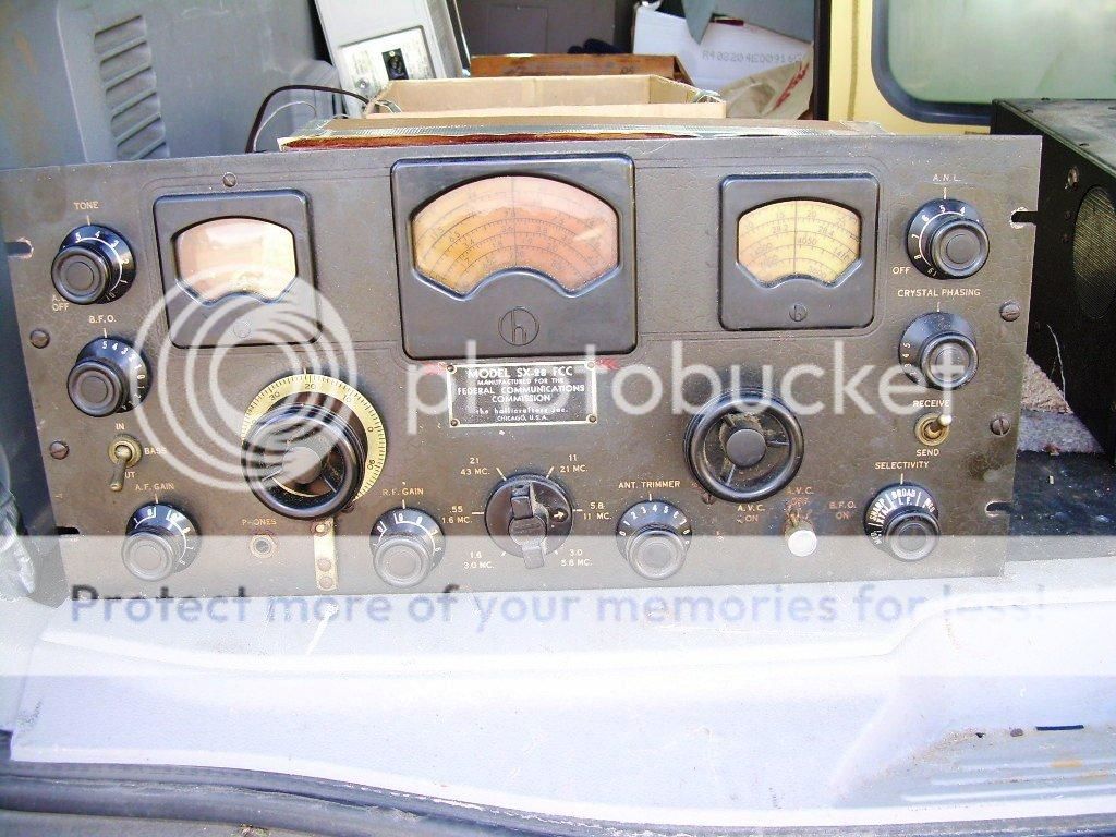

Is this considered a rare set?

Yep,you don't see them that often ! Could you also add pictures of the chassis and underside ?
Nick

Scarce but not rare, most were used in nice safe and warm rooms on US soil mainly during the war when the FCC had monitoring facilities all over the country. Others were used in mobile equipment to help catch the bad guys. When they were sent to surplus many followed FCC hams home :o
I have a SX-17F which also has a single audio tube as well as an AC-DC switch for 117VAC/6VDC and a S mter zero switch on the front panel. I dont know if Halli privided a vibrator PS for the 17 or 28 FCC.

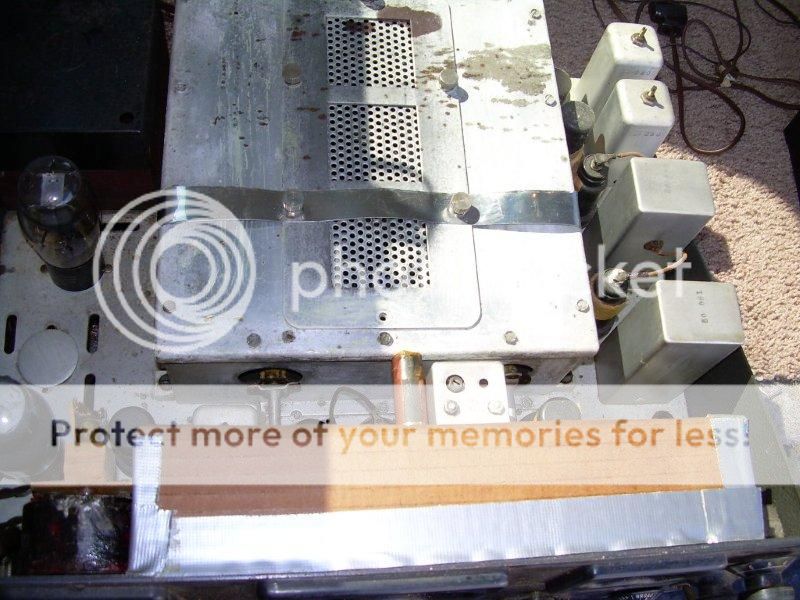

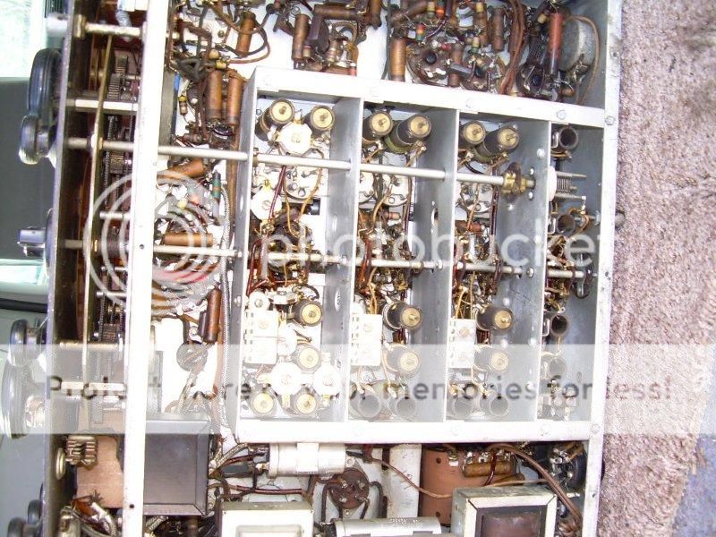

Here are more pics of bottom and top, caps are all original it looks.
 Post subject: Re: Halli SX-28 Made for FCC-Rare?
PostPosted: Mar Mon 19, 2012 1:46 am
Joined: Dec Sun 06, 2009 12:29 pm
Posts: 32
Location: California
Hey Lou
It looks all original underneath except for that modification on the top near the front panel.Whats the serial no. on your
SX-28 ?
Regards,
Nick

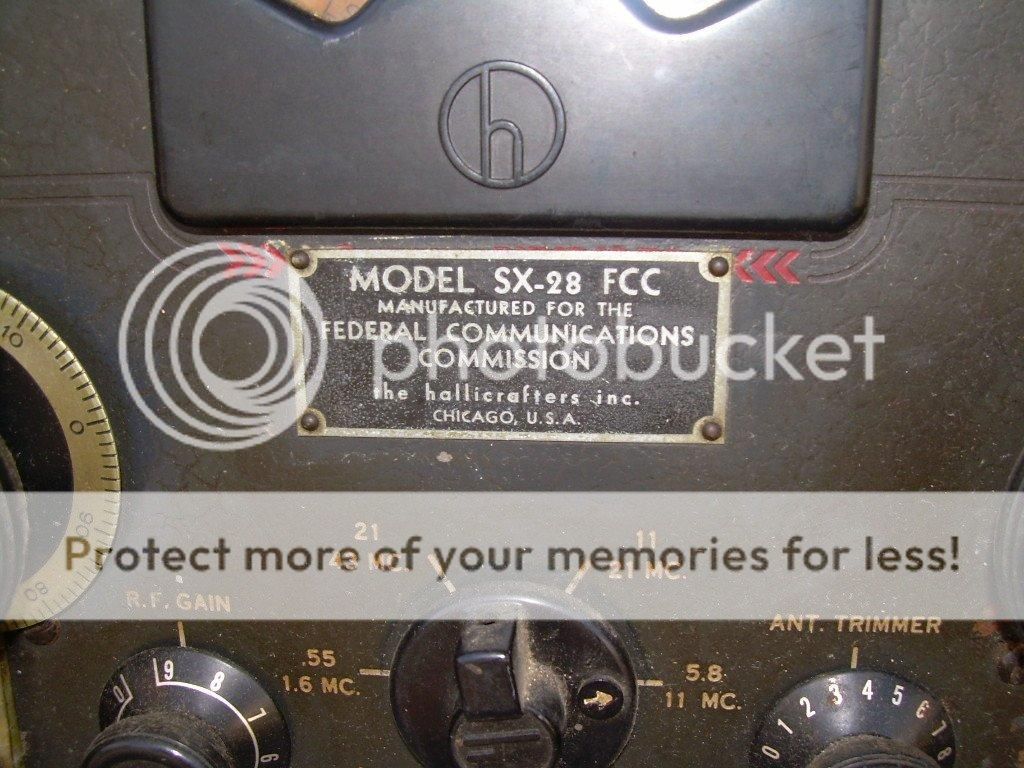

Does this receiver have the cabinet? Reason why i ask is, i have not seen the FCC label before altho the FCC FBIS
and so on used tons of them. IF you have no cabinet, i wonder if this rec came out of the "SSR-1" package,
which was an SX-28 together with McLoughlin sideband demodulator packaged together in a metal desk. This was
rated "SECRET" during WW2. I have photos of this unit, but i don't think you can see the label with good enuff
resolution. -Hue

Looks like it was either modified to single-ended audio, or that was a factory mod, judging from the hole plug on the chassis on the left side in your last pic. Hard to tell exactly, but does it have a pair of 6V6s or just one?
PostPosted: Mar Mon 19, 2012 5:34 am
Posts: 32
The FCC version had SINGLE ended output using one 6V6 as opposed to the regular SX-28 which had Push Pull output .
Nick
