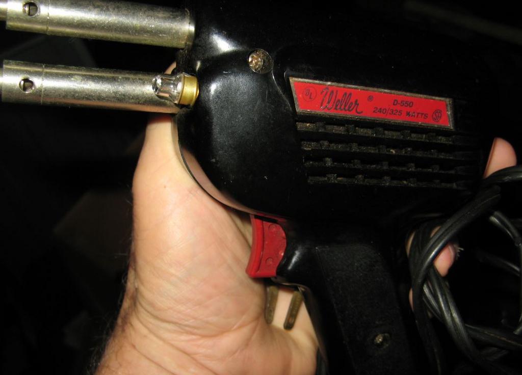

In shops in the past, when more heat was needed, the techs in the next
cubicle came over, with their irons. and several heated what was worked
on.
On the Weller D440 or 550 you could shine the tip all you wanted
but the heat came from reefing on tip nuts hard.
de
VE7ASO VE7ZSO
Steve Dow
on.
Agreed, if tip isn't snug, even the big gun is a effort in futility.
Before I adopted Bertha($15 antique/junk shop find), I'd have a 8200 in each hand.
At a 280 watts combined, they'd do the job but are somewhat clumsy.
With solder clenched in my teeth, I've soldered with a pair.
