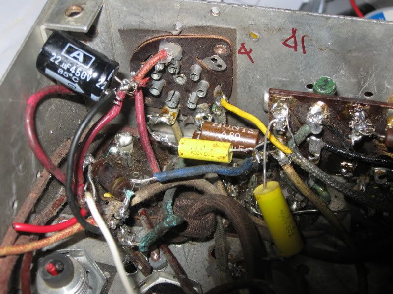

Buyer told me that the radio (Deforest Crosley Knight) he sold me was recapped. I told him that I would not plug in a radio I had not checked out first. Glad I did not power it up. From the schematics there is a 16 MFD and a 8 MFD cap and turns out the "radio guy" had a 10 MFD cap in place of the 16 and a 22 MFD cap where the 8 should be. The connections were made with stranded wires and strands were touching stuff they should not be. There are a couple of wires where the insulation is crumbling. Gotta stick to your guns guys and assume the "radio guy" before you knew squat. :)
Brian

He obviously mixed up the two replacements.

I will go thru the full schematic - it is not a complicated circuit.

So far I have found a 47mF cap where a 4 mF should be. More is better - right?
The caps that were replaced where just the easy ones.
The caps used were way out of range.
Wires attached but not soldered.
A wire from the center tap of the main transformer with one strand holding - the rest had burnt off...
Don't get me wrong - radios that work are no fun. :)
Don't know what the previous idiot has done here. What a mess...

Beware of that "Hunts" cap its spelt wrong & their failure rate even those in Transistor radio's is quite high. Had one in a car radio recently that had blown apart.
I can be accused of being pedantic as I have, pointed out several times even this week, that you check resistors as you change caps otherwise you are only doing half a job, in twice the time, as you then have to go back & find the dud /duds, if the thing fails to work, due to a preventable cause.
