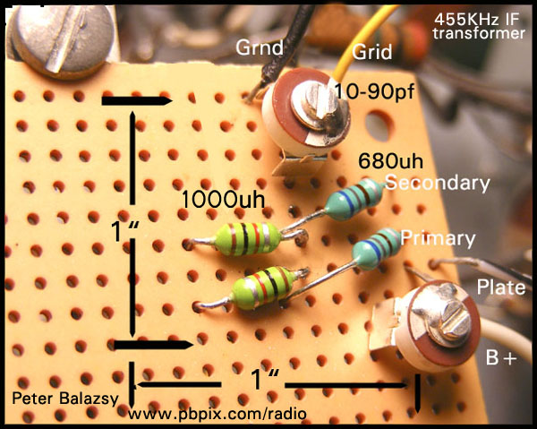

You do know... that if you're feeling a little creative and want to have a bit of fun... you can simple MAKE you own home-brew IF quite easily.
I did it and had great success immediately!
Here's my first one:
viewtopic.php?f=6&t=86652
And here's my 2nd one:
http://antiqueradios.com/forums/viewtopic.php?t=86553
I got the idea from this site:
http://www.angelfire.com/electronic/fun ... Can-1.html

Very interesting, Peter. How does the electrical flux transfer from the primary to the secondary though? In a conventional IF, it's through coil induction...
 Post subject: Re: Crack House Radio
PostPosted: Jun Sun 17, 2012 8:30 pm
Posts: 9185
Thanks ...
What makes you think this is any different?
The flux transfer is still happening between the inductor-coils. (conformal molded chokes)
The tiny (ferrite-core-type) primary and 2ndary coils are placed side by side in close proximity. I adjusted the distance while watching the scope for maximum coupling.
From what I understand, these (conformal molded chokes - 250 wvdc) coils are wound on a "barbell-shaped" ferrite core causing the maximum effect of inductive coupling out and off to the sides not top and bottom.
In the 2nd example I show the primary and secondary (1.2Mh each) coils placed side by side and positioned for max coupling.
In the 1st example you'll notice I am using two coils in series to add up to 1.68Mh (1000uh + 680uh)
So The primary uses 1.68MH and the 2ndary also uses 1.68Mh... the two sets of coils are also place in parallel and positioned for best coupling.
I suggest you try building one... it's extremely simple.. fun and educational... AND satisfying.

Yeah, the first circuit threw me off a little, with the cascading coils. So it's critical for the coil spacing, eh? Sounds logical.
I can see the second rig placed vertically inside an IF can, with holes in the side, ALA European style, for the cap adjustments. Do you think a metal can enclosure would have any bearing on it's performance, + or - ?

Conventional older style IF cans have the (pie-wound) primary and 2ndary coils positioned above and below each other
But ...
From what I understand, these coils (conformal molded chokes -rated 250wvdc ) are wound on a "barbell-shaped" ferrite core causing the maximum effect of inductive coupling out and off to the sides not top and bottom.
PostPosted: Jun Sun 17, 2012 9:25 pm
Posts: 8775
Right, so placing your setup, exactly as it is, in a vertical position, shouldn't have any detrimental effect on it's performance.
I was simply wondering if then placing an IF can enclosure around it would have any additional effect, either positive or negative.

First you need to ask yourself why the original IFs required a metal enclosure.. right? They probably radiated outward quite a bit.
You may find with these style that the whole thing doesn't radiate out very far at all and might not need any type of metal enclosure at all.
But go ahead and try it.
