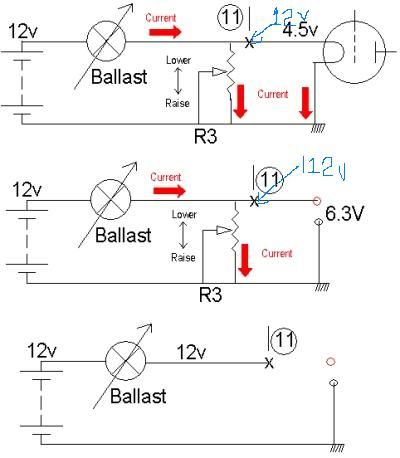

Let us ignore the decorations like capacitors & inductors and look at the basics. These are the principal components having a bearing on the voltage. The ballast tube is intended to maintain a constant voltage by heating & cooling in response to fluctuating input voltage due to constant changes on the loading on the utility supply.
This as how I see the circuit at it's most basic. See if this gives a clearer picture of what is going on under normal circumstances. Then with the removal of critical elements of the circuit.
Marc

Marc,
Nice job with the diagrams. I understand perfectly what you are saying. The problem is that my voltage readings are as shown in the diagram. Points X and the heater should be at the same potential since both are after R3, right?

That would reverrt to the last drawing: I have serious issues with the way that that potentiometer R3 is. If it is installed the way it is described on the circuit, which is crazy. It is eventually going to be a short circuit, controlled by the ballast, which may then fail.
If R3 has failed and the tube, is out you get 12V across the heater pins and you may get quite high volts with it in. If the ballast tube has failed shorted, you will get no regulation. I would expect it to glow like a dull globe if it's working & has some load on it. With no loading I would also expect more than 12V from the rectifier.
Check those parts& report back.
Marc

For the interested parties the 6AF4 / EC94 heater current is quoted as 0.225 Amps. The resistance of the entire line between 11 and the heater pin (tubed removed, would be interesting). Is there any idea of what wattage the rheostat R3 is. I would wonder if it should be wired as a pot & the tube current draw off of the wiper? In reality if the chokes have resistance and are not wholly reliant on R3 to pull the voltage down I would expect a maximum of around 25 ohm. But without seeing how much wire is on them, in this circuit I would expect less
Read R2 of the voltage divider in drawing as R3 and R1 the ballast. If it proves to be a PIB, we can be naughty & replace the ballast with a fixed resistor and R3 with a Zener.
What we have at the moment is a quasi voltage divider circuit, that will be a little confusing to those who have never dealt with a voltage, divider. Voltage dividers are quite common on screen grids.

Actually, it is not reverting to the last diagram, and that's what I find so confusing. It is actually a combination of the last drawing and the other two drawings (with the osc. tube in, 12 V at point 11 and 4.5 V at heater pins and with the osc. tube out 12 V at poiint 11 and 6.3 volts at the heater pins.

Mystery solved!!
Measured the resistance between point 11 and pin 4 (the non-grounded heater pin) of the RF oscillator tube and found it to be almost 1K (964 ohms to be exact). On further inspection I noticed that the wire going to the first RF choke between point 11 and the heater pin 4 had been replaced (looked different than the other wires). I measured the resistance from point 11 to the point of connection of this wire and found that the wire accounted for almost all of the resistance. What was even more curious was that the original wire had been disconnected at this point but was left in place. Initially I thought that maybe the original wire was open and that was why it was replaced by the more modern-appearing wire. But, on checking resistance between point 11 and the disconnected end of the original wire, I found that the wire was good and showed a very low resistance of about 1 ohm. Also, on further inspection I noticed that the ballast tube is a 7TF4 and not a 6TF4 that is specified in the schematic. The ballast tube filament shows continuity. I looked on the web for specifications of 7TF4 vis-a-vis the 6TF4, but was not able to find any information on the differences between the two tubes. This clears up the mystery of the voltage drop between points 11 and pin 4 of the oscillator tube, but it is not clear to me why the instrument was modified in the first place? I am postulating that this modification was made presumably to make a 7TF4 work in place of a 6TF4. But why would someone go through all this trouble when a 6TF4 is probably just as easily available as a 7TF4?

Thanks to the suggestion from Tube Radio, the mystery is solved. I had previously measured the resistance from the start of the series of the RF chokes to the heater pin and since the resistance was quite low, I was puzzled as to why there was a voltage drop. It never occurred to me to check the resistance from point 11 to the heater pin of the RF oscillator tube. Just goes to show that one should never assume anything - my mistake was to assume that the wire between point 11 and the first of the RF chokes was an ordinary wire and would not contribute to any voltage drop when in fact it turned out to be some kind of coated resistance wire which for all the world looked like an ordinary piece of hook up wire.
