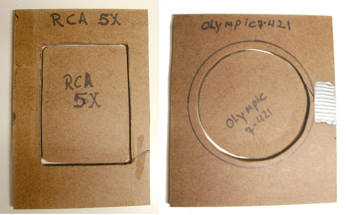

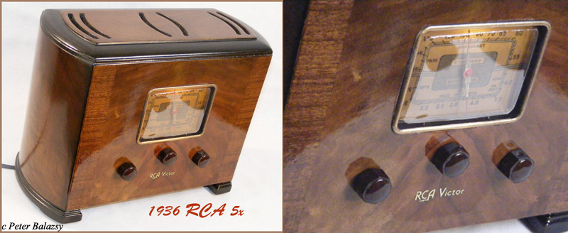

I have made many.
I use Masonite.
I place the Masonite behind or in front of the opening and draw the opening's shape on it.
I use a piece an inch or two larger than the opening.
Then I use a scroll saw and cut in from the outer edge to reach the inner shape line I drew.
Then I cut the inner shape out.
That makes an inner-shape and an outer collar with a slit in it that I cut from the edge to get in there.
I use duct tape to cover the slit in the collar and hold the collar together better.
Then I use a rough file or Surform tool to soften the edges of the inner form and the collar.
The inner form will then fit very loosely inside the collar.
Then I use a piece of 15-20mil Polycarbonate plastic (some guys use PET plastic) or such about an inch or so wider all around than the inner form and lay it over the inner form and put it in the toaster oven.
When hot enough the plastic will start to droop down over the edges of the inner form.
At that point I open the toaster oven and place the outer collar firmly down over the top which helps shape the edges more distinctly.
It cools in a moment or two.
Here's an easy little one I made for my RCA 5X:

Could you post a picture of the masonite piece that you have cut out? A picture says a thousand words. Thanks.

 Post subject: Re: Making a plastic dial cover
PostPosted: Aug Sun 19, 2012 4:31 pm
Posts: 9334
Okay, I added images of a couple of the typical Masonite templates I made in my post above.
