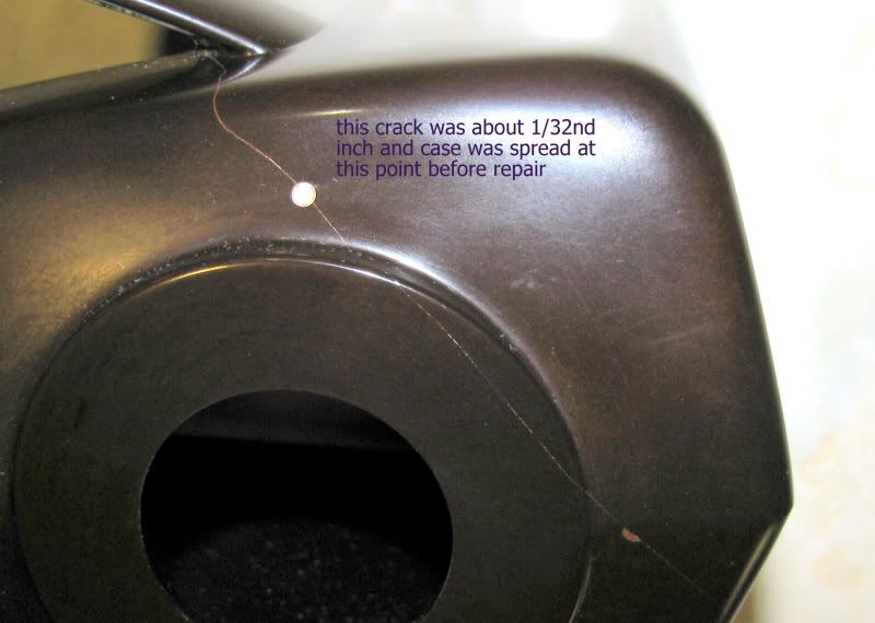

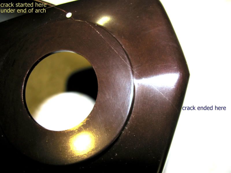

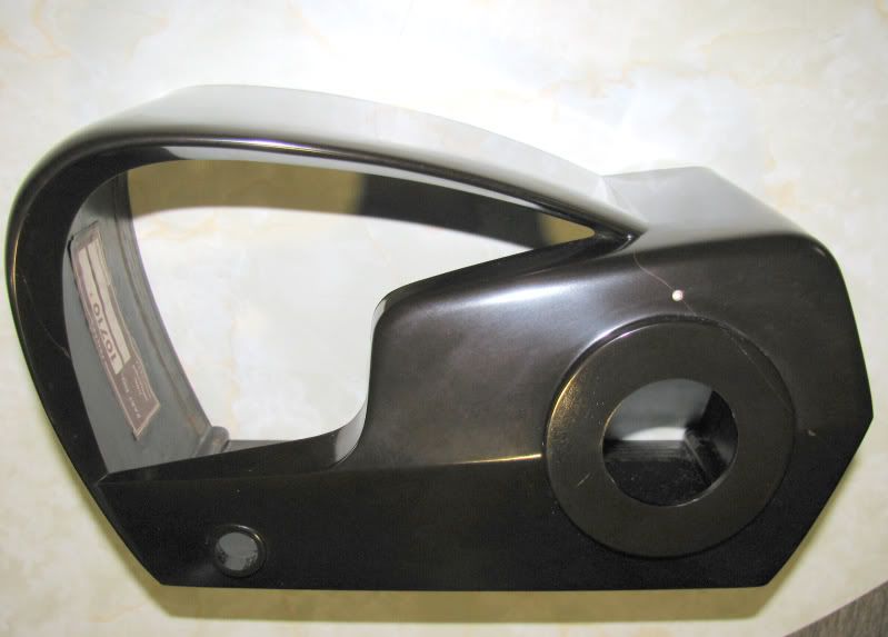

After many years of wanting one I finally got a trade deal on a nice brown bakelite 49-501 Philco, the Boomerang. Sadly I had to take the deal on an as-is since the set I traded had some damage I got a set in return that also had damage.
There were two cracks in this case, one running inside the arch on the left side by the grill about three inches long and another on the right side from the end of the arch at the top of the cabinet all the way down and across the dial area to the right side of the radio on the corner of the cabinet.
I debated long and hard about whether to take the trade deal but this was a one shot deal to get a set I had wanted for nearly twenty years so I took it and with all the commotion around here lately with the wife's illness and then the news of us having twins :shock:, I never got started on the repair of the cabinet.
Last night I decided I needed a break and saw the Philco calling me from the shelf downstairs by my bench. It was dirty, cracked and looking pretty sad so I cleared a space on the bench and disassembled the set. I boxed the chassis and knobs for safe keeping and set them aside for a later time and got down to seeing what I could do to save this cabinet as the cracked area was causing the case to flex and I was afraid it might get worse since it already had a gap of about 1/32nd of an inch when the case was pressed in any direction. I knew clamps would not work on this case due to the odd shape it has and the fact that I lost my web clamps in the sewage flood in February. This time it was going to be all hand held and hold on till the glue set up so I decided to use my technique of wet flowing the bakelite using Super Glue (cyanoacrylate for you chemist types out there) and sandpaper to help it set up quicker and fill the small chips that had developed on the edge of the crack.

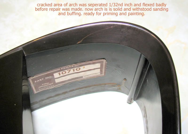

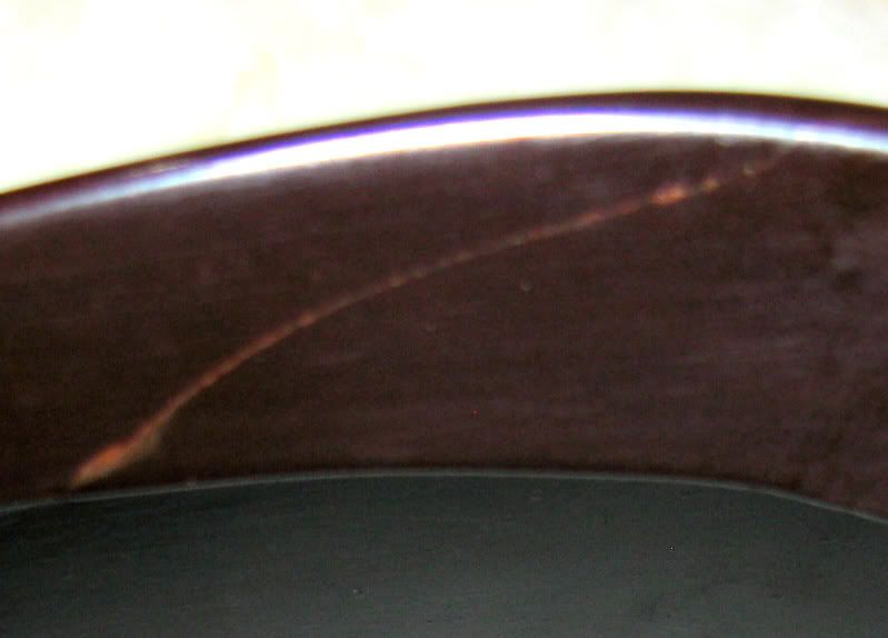

Starting from the inside of the cabinet I cleaned it thoroughly with ammonia and a toothbrush making sure to clear the inside of the crack of all dust and debris. Next I got my 400 grit sandpaper at the ready cut into strips about an inch wide for easy use and control.
I started first on the arched area of the grill for this process as it was more flexible overall due to the thinner nature of the material there and finished the process on the dial side area.
After making sure the crack was dry and clean I held the crack open as far as possible without creating so much stress as to make the crack worse and ran a good solid bead of Super Glue in from the inside of the case allowing it to ooze out the other side to the front of the cabinet where I immediately hit it with the 400 grit paper and began sanding it back into the surrounding bakelite as I held the joint tightly together.
The bakelite dust that the sanding generated mixed in with the wet glue and began to solidify into the crack and around it to form a new surface that filled in the gaps and got hard quickly from the heat of the sanding. After the first coat I immediately laid down a second bead on the outside of the case over the same area and repeated the process moving to fresh sandpaper as I went along to keep the surface smoothed out and level as I continued to hold the joint tightly together, making sure to get a good three coats on all areas before calling it done.

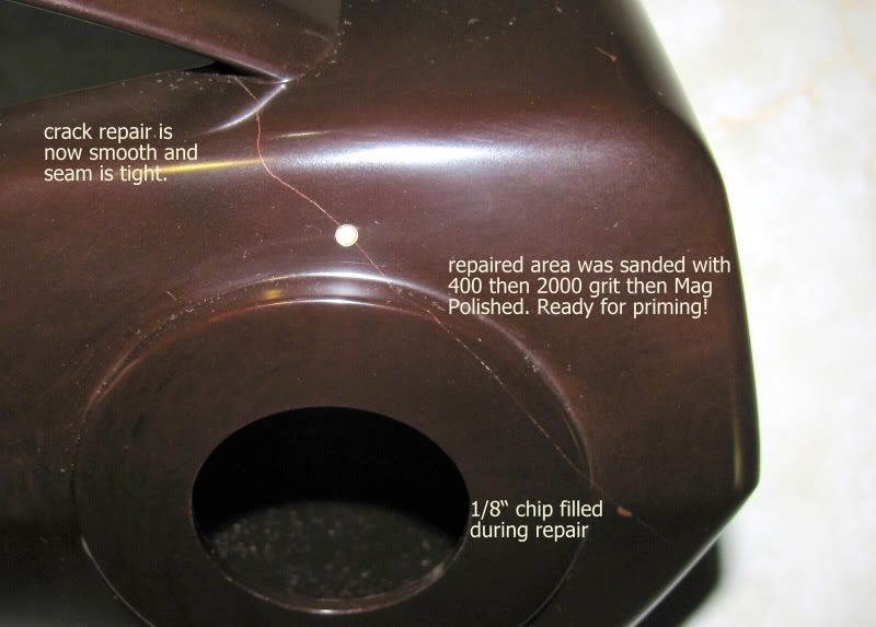

There was a small chip in the case next to the dial area to the right that was about 1/8" long and the process completely filled the chip and the sanding made it level with the surface of the good bakelite so the chip isn't even felt when you run your fingernail over it now.
When I finished after a few minutes of sanding the area looked like the crack was completely filled in and I still held it secure for another two or three minutes to let it set up solid. Taking a paper towel I wiped off the inside of the cabinet of any still wet glue that had not begun to set up.
I then began to sand lightly on the outside to smooth off the area I had just reworked using a light touch with clean 400 grit paper .
I then set the case aside for the night to let the Super Glue set up completely overnight.
Tonight the case was solid as a rock and the crack was gone save for the line where you could see the filled section of the SuperGlue/bakelite mix. A final sanding with 2000 grit finishing paper and a clean and buff out with Mothers Mag Wheel polish made the case look like new and ready for the primer/paint process to come.
The crack is solid now, the case no longer flexes like it did and the only other thing I plan is to paint the inside are of the crack with epoxy resin to give it more material to bond with over the years. I have repaired several of my painted sets like this in the past twenty years and not one has ever developed any new damage. I know a lot of guys like to use the epoxy resin with the fabric but this seems to work fine for me and never a failure...yet :wink:
I have also used this technique to make a "bakelite spackle" to fill larger gaps and chips by using a scrap piece of bakelite to sand into dust and just add a few drops of Super Glue to the dust to make a filler that works great for small surface chips and voids that would otherwise mar a nice paint job. Just lay the sanded dust into the chip and apply the glue and start sanding right away. Practice makes perfect but this does work. And while there are some very good costly brands of Super Glue out there (even a black type that is SUPER strong!) my technique just uses your average dollar store three for a buck squeeze tube type. It works fine for this process as the bakelite dust acts as a binder and strengthens the repair.
BTW, one word of caution if you try this process, USE LATEX GLOVES! The dust and Super Glue mix is going to stick to your skin otherwise and it is a pain to get off and make sure you have a source of moving air (fan) by your work area to move the fumes out of the way as the Super Glue gives off cyanide fumes (that burn like all get out) and the bakelite dust will get into your nose and eyes and make you feel like you inhaled a camel otherwise.

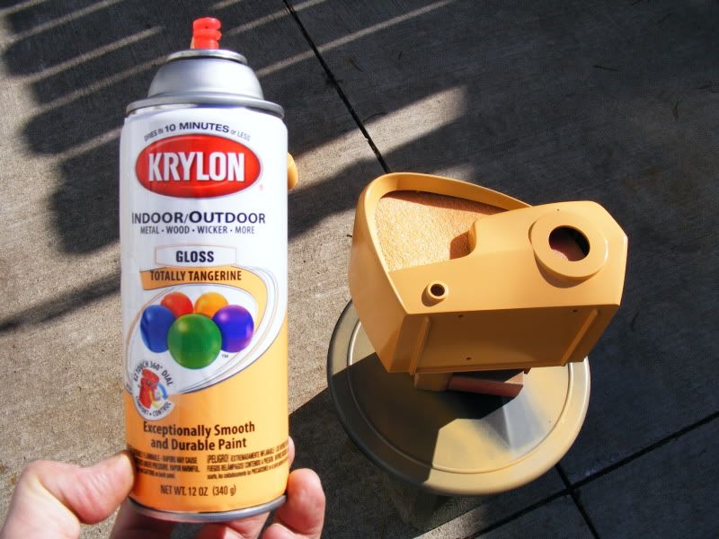

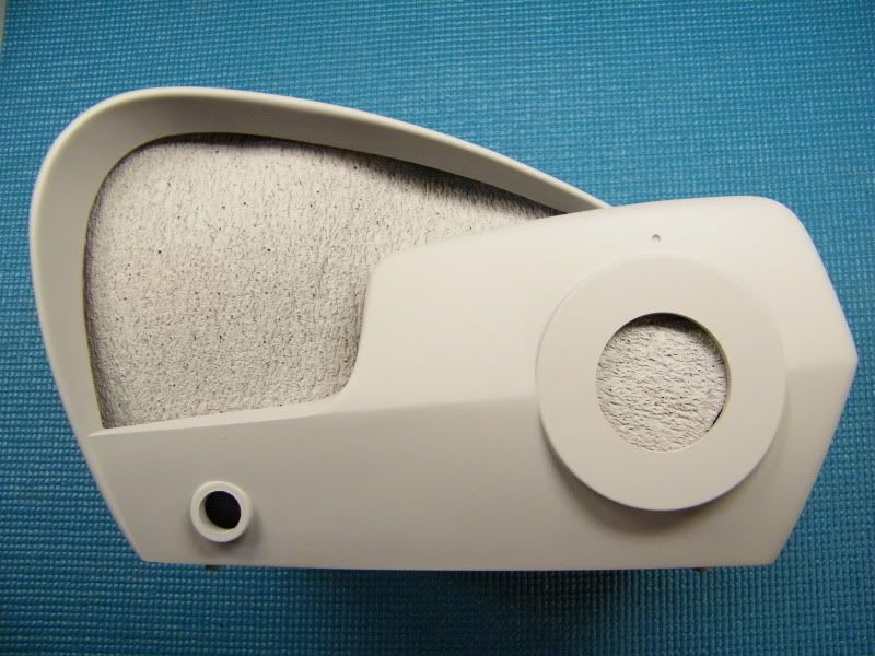

Today I decided that since it was dry and low humidity outside to try to get a quick coat of primer on the cabinet to see if my work would hold up to a finish coat. I know time is flying and the twins will be here soon so my chances for getting a finish coat on this set before winter are quickly disappearing. I did my usual tack cloth prep and set about doing the primer coat. It was very windy but the house acted like a wind break for me and after some fast and furious spraying I had a smooth prepped radio. It came out nice I think.
The repaired area where the crack was is no longer visible and once the primer sets up a few days I'll do a light sanding with 2000 grit to level off the high spots and get it ready for the color coat. This one is going to be a sweet looking peach/salmon finish with red accents and I'm even contemplating a flame job to make it a "rat rod" look. I have to see if there are any sources for waterslide flame decals such as those used in model kits available. I just know I'll get "flamed" for that idea :shock: :lol:
I'm curious to see if anyone else has completed repainting any of their sets using the superglue repair tip with photos of the finished efforts.

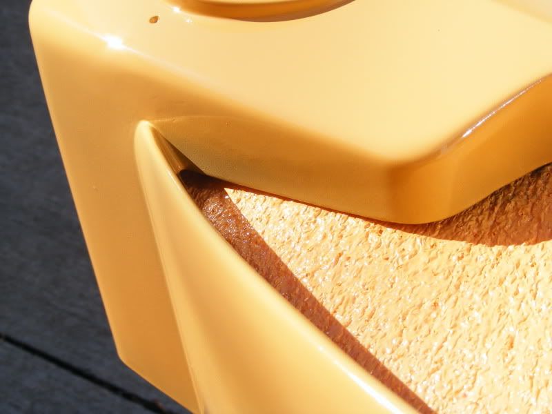

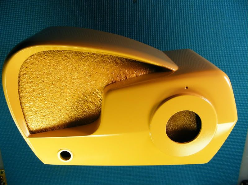

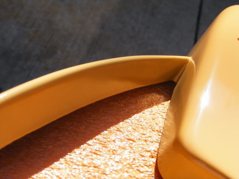

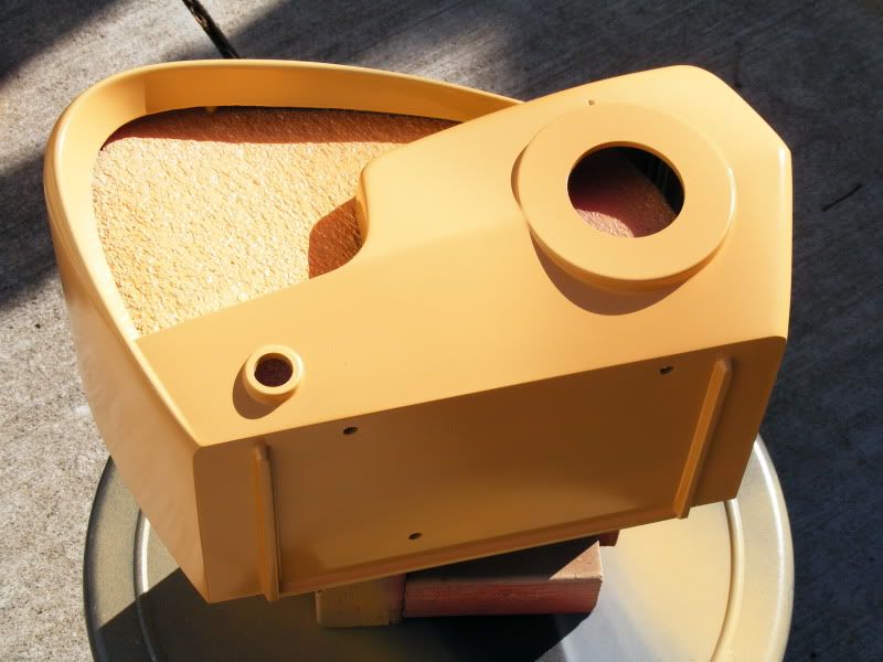

Well, with the advent of the last few days of warm weather this past week I started to try to get the paint job done on this Boomerang before winter sets in. I already had the primer on it so I shot the first color coat last week and promptly goobered it up with two bad runs in the finish from getting too hurried with a color that was too thin to lay on a heavy coat. I forgot from previous experience that Krylon has some colors that are just thin, Ivory is one and this tangerine is obviously another.
I had to let the paint set up a week so I could cut back the runny areas and clean up the mistake. I got it all ready for a quick primer touch up which I did on Thursday of last week before I went to work. The biggest problem area to get right on these sets is the corner of the arch on the right side:
as it will run in a heartbeat since the paint will pile up there if you try to get it all in one fast coat. You literally have to fog the color in there over several coats and having the adjustable spray head on the new Krylon cans is the key since you need to alter the angle of spray that hits the cabinet to prevent the runs from occurring.
After several coats at different intervals of time over about a half an hour I finally got a color base I was happy with:
The first town photos are closer to the actual color as the last one was taken inside on the bench
Now all that is left is to clean up the tiny dust specks that settle on the cabinet as I waited between coats and then a few coats of clear to seal it all off. The grill screen will need to be painted but I'm not sure whether to do it in black or ivory and to do the knobs in red trim. And I'm still debating those flames as I found lots of great waterslide flame decals available online. This should be a standout set when it is done and I already have a spot for it in the display case
