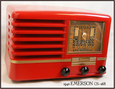

Is that the Fusion "red pepper" color?
btw...( it's called "Fusion" only because it has a chemical in it that slightly melts the plastic surface so that the paint and plastic "fuze" together)
So ...It has no special effect on Bakelite though because Bakelite is impervious to solvents. However the paint does lay down like glass on anything you put it on.
That's what I used on this Emerson CS-268 4 years ago ( gee time flies! ... and holy cow ...I'm still wearing the SAME pair of sneakers I wore that day with red paint drips on them... lol)
I can't remember now if I rubbed it out afterward or not now.
But I probably might have used some 0000-steel wool & rubbing compound ... and certainly Butchers wax afterwards... but not sure about the compound.

superzeeman wrote:
On top of the shine it already had, I clear coated it with gloss lacquer. Thing glows in the dark just about.
Your saying you can shoot lacquer over the fusion paint?
I would have thought the lacquer would attack the other???

Lacquer over the top seems fine. I did test it before I did it and have not seen any thing strange. I just had it laying around and was to cheap to go buy more clear. I think that the 7 days for a full cure sure pass, and I didnt do that. It might take longer to fully cure. I wont have the chassis done for a week or so, hopefully cabinet will be fully cured before assembly. I can only hope mine to look as nice as that Emerson. Slick is what that is. Anything looks better than the dude on Fleabay doing the swirl oil paint dipped in water trick. Ish. :)

The paint should fully cure/dry an about a month. Yes, that will still outgas and evaporate, even though you think it is totally dry. Smell the paint finish. If you can still smell the paint, it's still drying.
Lacquer on top of Fusion enamel? I wouldn't You might get lucky if it goes on thin, and dries fast. But if it doesn't dry, or it pols like in a corner, it will eat into the enamel and give you wrinkle paint :shock: If it doesn't you still make have a peeling condition somewhere down the line.
Now, you know they make a clear enamel. That might be a better choice if you want to apply clear. Generally, a nicely sprayed enamel will not need a clear. I'd prefer a semigloss finish on an old set. Glossier than satin, but duller than high gloss.
