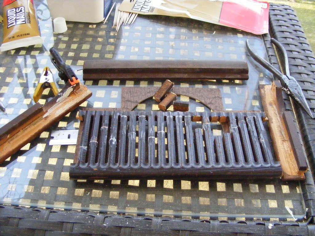

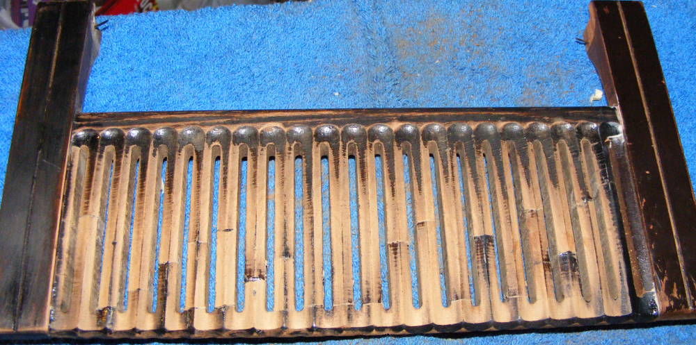

It has taken me a while but I finally finished the cabinet for my first restoration. It's a General Electric LC-628. I'm not 100% pleased with it but I think I did pretty decent for a beginner. I might have stripped it if it wasn't for the photo finish and the decals.

Nice job! How did you repair the broken grill? What process/materials did you use to get those results?
I intentionally broke it apart the rest of the way. I then put it all back together again using liquid nails. It took me longer to finish the grille than anything else.

Salval wrote:
Very creative grill repair, thanks for the walk through.
