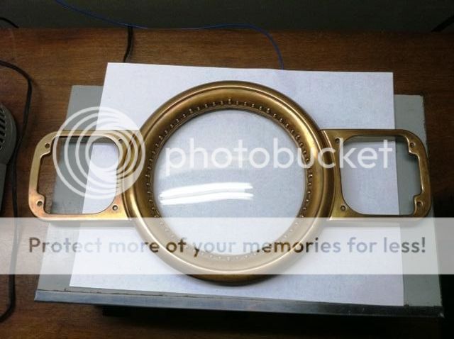

Well, I would have to disagree. Here's the way the bezel looked on my 8S-463 before, and then after;
After all, if one is going to restore a set electronically to make it play like new, why not remove 70 years of grunge and have it look like new as well?

I used Brasso, the current formulation, and plenty of elbow grease.

Problem is, these escutcheons never looked like this, even when they were new. The shiny, mirror finish brass that a lot of people go after did not come into being until the second half of the 20th century. I see people make this mistake all the time with door hardware in older houses. Most brass hardware was sold with an "antique brass" finish on it back then. I am assuming this was to go with the Colonial-inspired architecture/decor of the era. Soap and water is as far as I'll go with pre-1950s brass hardware. If there's a ton of grime buildup, I may use a diluted de-greaser on the worst spots, but nothing else.
