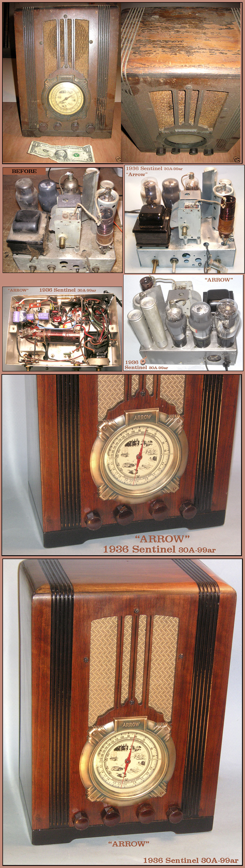

I cleaned up this old Arrow radio escutcheon, but it too looked too shiny. So I "aged" it by spraying a little green spray paint and a touch of gray.
Then I buffed most of that away with steel wool except in the nooks and crevices. That made it look more normal. Then I sprayed it with a coat of satin lacquer.

That looks so nice Peter, that it almost looks fake.
 Post subject: Re: Preparing Brass Trim for Spray Lacquer
PostPosted: Jan Sun 08, 2017 3:18 am
Posts: 19675
Thaks Scott!
Fake? Which.. The escutcheon or the whole radio?
or do you just mean the patina ageing looks fake?
Or do you mean the close up image makes it look bigger than life?

Peter, what you did on the Arrow bezel looks very good. It is appropriate to the level of restoration and I like the highlighted look. To me it looks like that is the way it is supposed to be. Did you do that with fine steel wool?
PostPosted: Jan Mon 09, 2017 12:23 am
Posts: 19675
Thank you! Yes... I probably used 0000 wool. But anything else might work just to rub off the excess.
