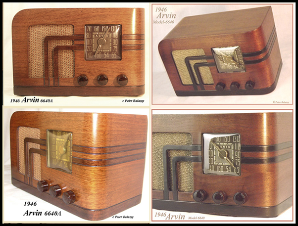

I used to use lacquer often with great results. But the over-spray dust got on EVERYthing in my garage... cars included. The temp and humidity are a factor and the freezing cold in the Winter all got me interested in a good alternative. That's when I was watching The New Yankee Workshop w/Norm Abram.
He was using Wipe-On-Poly on a table he was making and he said this Wipe-on-Poly is really perfect, "It's truly a product whose time has come."
Then he demonstrated the use and showed the final results.
That was it!
That was good enough for me.
I love that I still get the same ultra beautiful results and no over-spray. No drip no runs no problems!
That's all I use now.
You can even easily make your own by cutting "regular" Polyurethane 50% with mineral spirits.
Saves a lot of money.
I understand it is available in water-base too... but I haven't used that yet.
Here's a side by side comparison. One was finished w/Wipe-on-Poly and the other w/lacquer.
Can you tell which is which? .. I doubt it because I cannot:

Very interesting. I did not think there was a big difference when I brushed on the poly years ago.
This looks like a better way to go.
