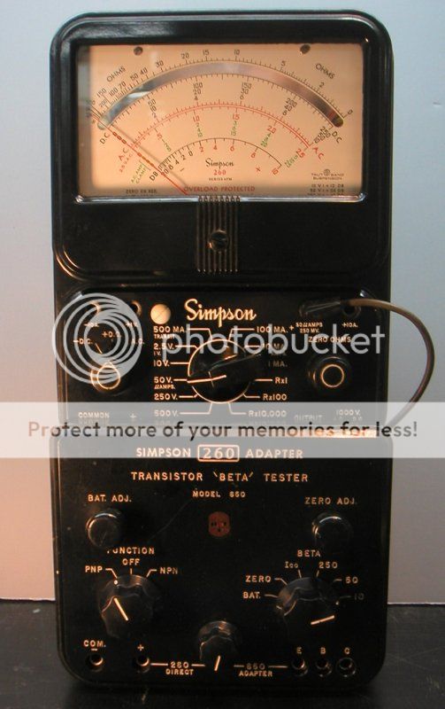

Found a few pics over on the simpson site, but no manual.

I've been all over that site. The question is if the range switch is actually in the correct position.

Isn't the 50uA range basically a direct connection through the 260 meter?
Looking at the pictures on the simpson260 site, and the presence of batteries in the adapter itself. I'd guess the picture is correct. (50uA setting, and the plug to the 50uA jack.) It looks like all they're using the 260 itself for is little more than an analog meter.
The 652 manual which is available:
www.simpson260.com/downloads/simpson_65 ... manual.pdf
Is similar... 50uA range, 50uA plug..

Just looking at the pic above, I see "Transit" in smaller type right below the 500mA switch position. Since a transistor is a current amplifier and leakage is measured in microamps, I'd say that's where the 260 should be set for beta gain readings. Perhaps the 100mA range would be better for checking leakage.
The "Transit" position marks the range setting that has the lowest shunt resistance across the 50 uA meter movement. You're supposed to put the range switch in this position before transporting the meter. This position has the highest damping, minimizing movement of the meter armature during transportation (i.e. while in transit). See section 4.15 of the Simpson 260 series 6 manual.
Nothing to do with transistor testing.

Thanks Steve, I thought it was an odd abbreviation for transistor.

I concur with Steve. During the early 70's I was in the Navy, repairing 100's Simpson 260's adn we always shipped them back in the "transit" position to minimize needle vibration. I should have the manual for the communications tester (CB) adapter that was also sold with the Simpson. Seems the manuals for different models of the meters themselves are now pretty available, but I have a few of those also. Also some small parts and a few old boards if anyone needs small parts or resistors. Let me know if anyone has such needs.
Hopefully John will send out a copy of the manual next time he logs on.
The brief instructions that were posted seemed to work for me to get some Si transistors tested with my adapter. Cable in the 50uA jack as all adapters seem to use, switch in the 50 uA position. Batt seems to bring the meter to center scale, I am testing through all my "collection" of power transistors, found some that are likely Ge transistors that will not test on this adapter. They are either bad (most do fail the DVM test below) or I need to understand more about testing Ge power transistors with the 650. I haven't been able to successfully gain a zero with any devices by pulling out the Zero control on the 650, possibly something with using a different range? Will need to play with that a bit more.
