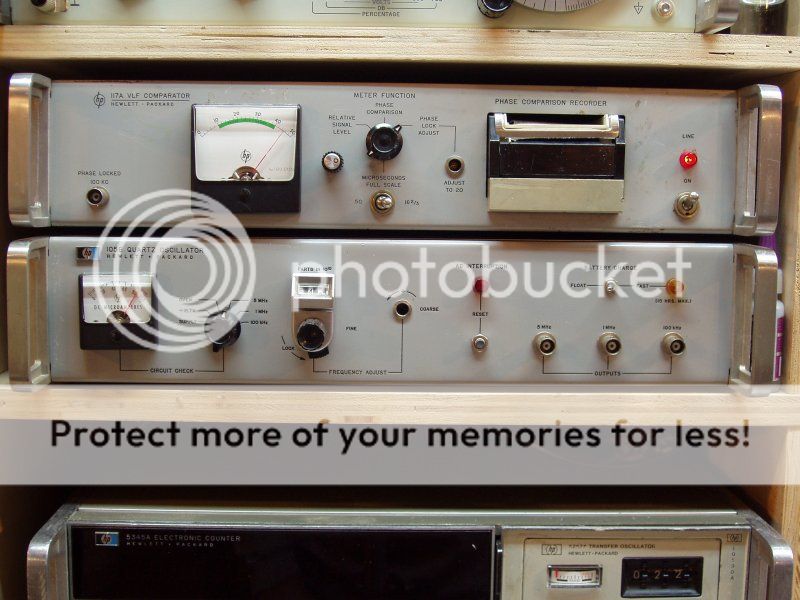

PostPosted: Mar Fri 09, 2012 5:18 am
Posts: 3174
Now, if you have a WWVB receiver, that's another story altogether.
An HP117 WWVB VLF receiver/phase comparator, driving an HP105 crystal oscillator, modified, with a newer HP10844 TCXO. I mated the two by disabling the 117's original phase locked oscillator, and substituting the 105's new TCXO.
Adding the newer time base required some level shifting in the 105 to handle the phase lock error signal from the 117, and added a divide by 2 to bring the TCXO's 10Mc output down to 5Mc to drive the original phase locked dividers in the 105. I saw no valid reason to replace them. The only operational difference for the 105 is that the original 5 Mhz output BNCs are now 10Mhz.
