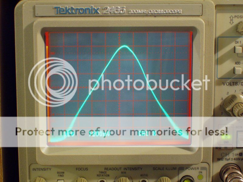

To me, the most convenient aspect of using any of the generators mentioned are their frequency management attributes. With the 3336 generator, you enter the start frequency, stop frequency, and the amount of time you want the generator to take to sweep from start to stop. I presume the 3325 is very similar. With the 8640 you need to know the frequency deviation per volt of applied ramp signal. I have an 8640 but never used it as a sweeper per se. On the scope's screen, it's own scales eliminate the need markers. Markers are so necessary when using older "free running" sweep oscillators, so you have an idea of where you are, frequency wise.
Here is a 30Kc wide sweep of a BC348's IF strip. Each vertical division across the screen is 3Kc wide, and each horizontal division is 10db. You can easily determine that the peak is at 917 Kc, the frequency of the receiver's crystal filter, and the total dynamic range of the sweep is 70db.
As Pete mentioned, sweeping this type of receiver borders on a total waste of time, but nevertheless, its interesting sometimes, to actually see the performance of these old receivers. Another common method Pete mentioned, of aligning the I.F. on older receivers, is to measure the receivers audio output using a modulated signal generator. you simply connect your VTVM across the speaker's voice coil, or use a metered, switched load like the GR-1840 audio power meter.
